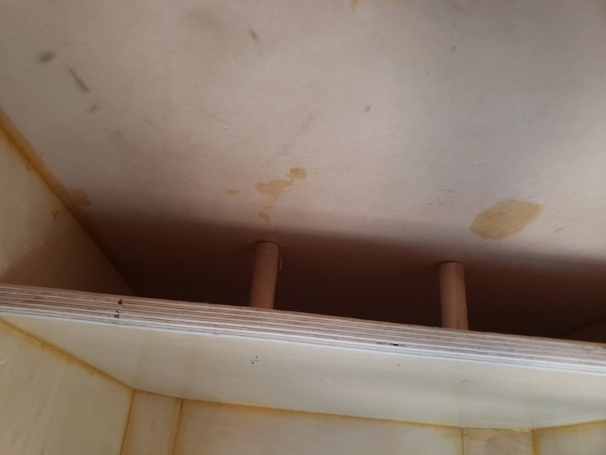

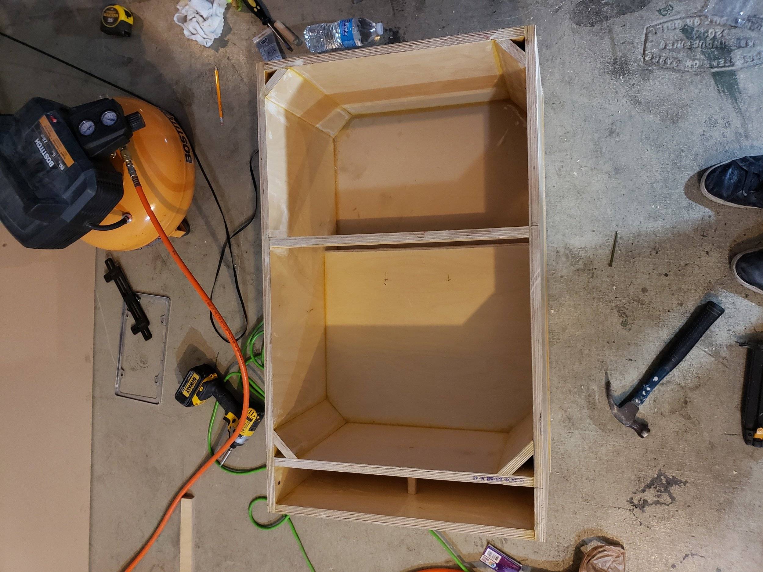

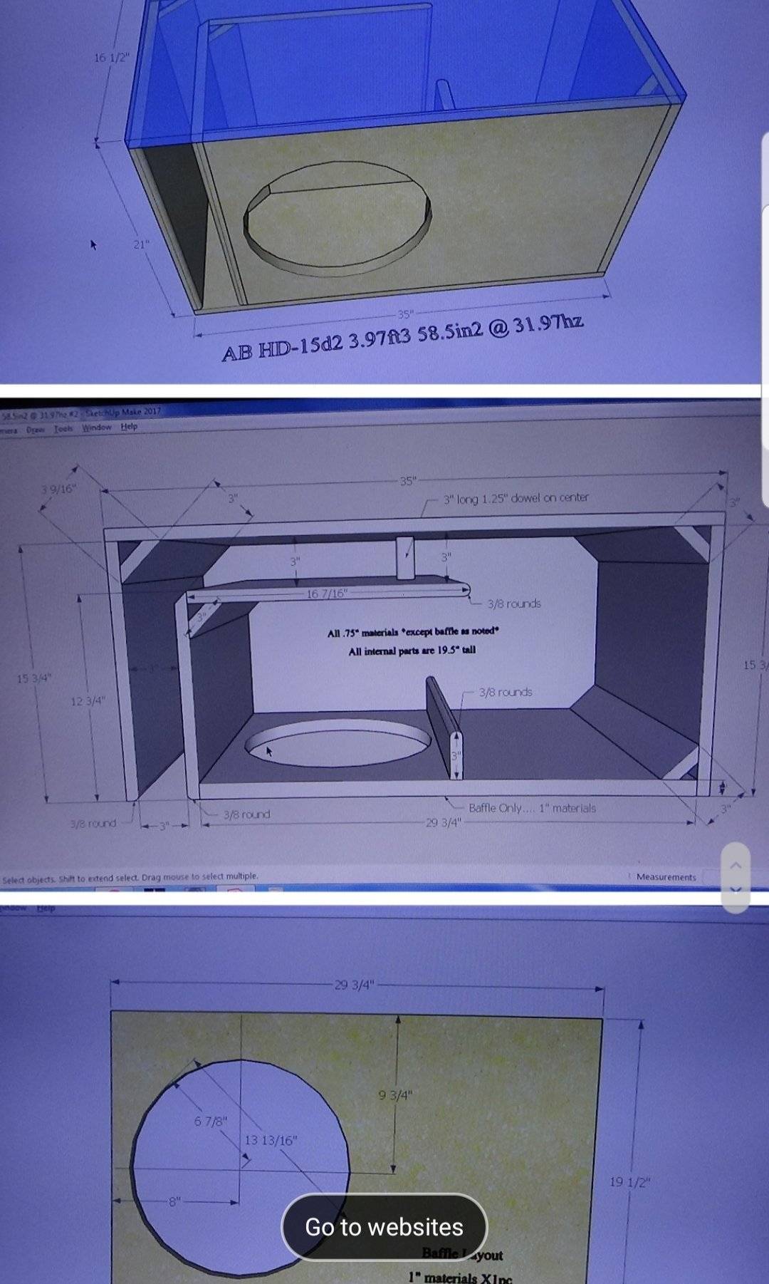

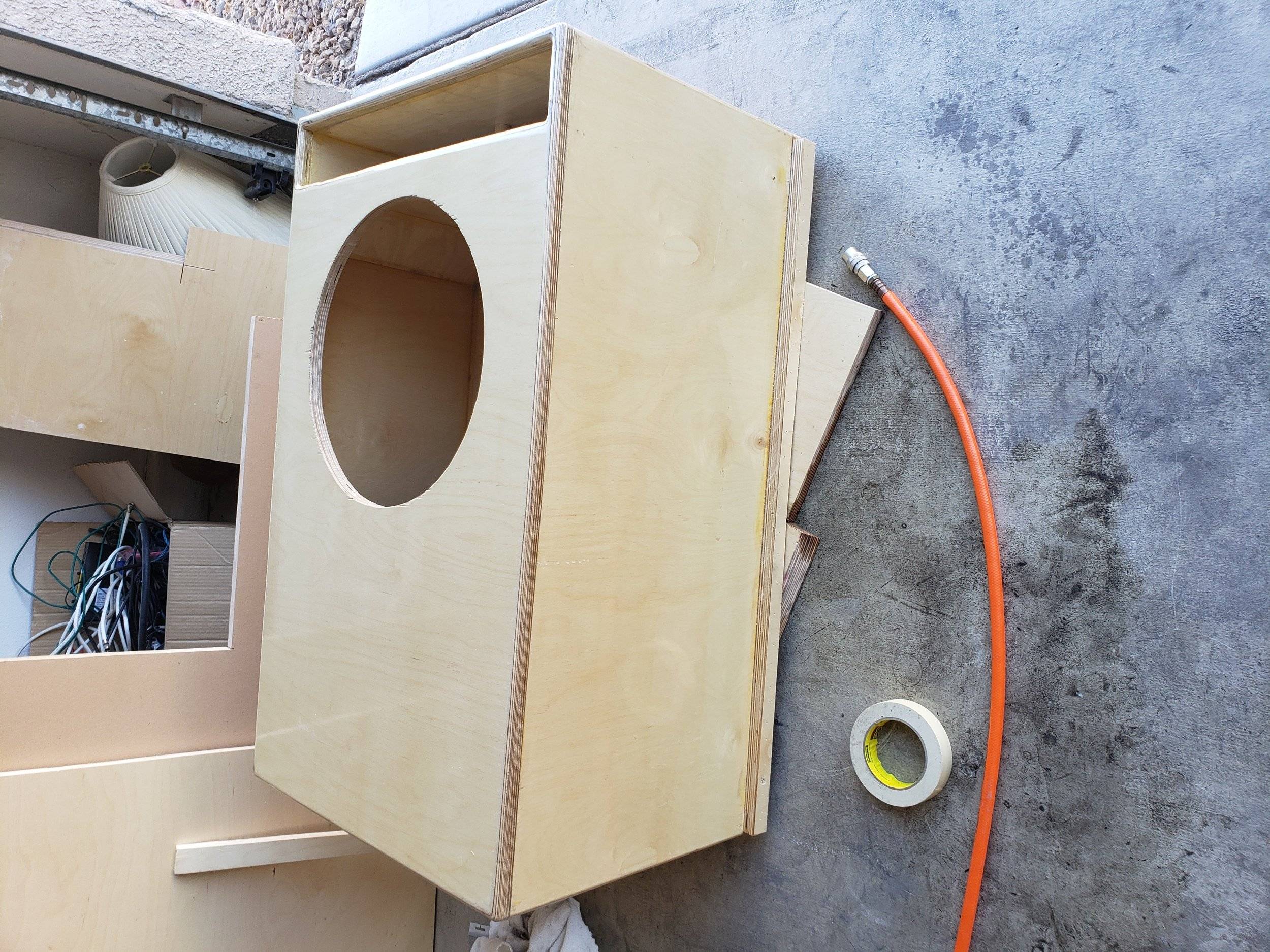

Jeff, that's what upset Shredder2. I built the top a different way just for structural reasons. The cubic feet was never messed with. 5.57 before port, sub, and 45's. Around 4.0 net tuned to 32. I think it turned out alright. 3/4" clear coated birch. Wet sanded and cleared again.
Without the 45s, its not the same cubic feet he'd design for. The 45s take up space so thats probably in his calculations. Its really no big deal, you are just slightly peakier and lower tuned but literally makes zero difference like .1%
Jeff, that's what upset Shredder2. I built the top a different way just for structural reasons. The cubic feet was never messed with. 5.57 before port, sub, and 45's. Around 4.0 net tuned to 32. I think it turned out alright. 3/4" clear coated birch. Wet sanded and cleared again. View attachment 19252View attachment 19253View attachment 19254
Ports were supposed to go vertical top to bottom in all corners except the one near the port wall and sub cutout.. Doing them horizontal front to back could change the airspace if the depth of the box is different than the height.
The port is exactly as Shtedder2 designed it wiseguy. I fugked up the 45's and built top with three points of bearing instead of two. The air space was never changed. Nice try though.
