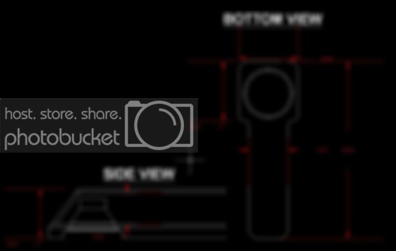

JL and MTX both make "stealth" and "thunderform" boxes that are console units to replace the factory console. I've had a thunderform in another vehicle and was pleased. If they can do it with molded plastic, I should be able to do it with MDF and a little creativity.
Did a little fiddling and came up with this, not a complete design by any means but just something to get started with.
I'm sure you know much better the dimensions you are working with. But to start this is roughly 1.25 ft^3 Might be able to gain a little more height depending on what you want, might have to squeeze it down on the sides a bit too depending on how close together the seats are, but in any case give ya an idea of what you could do.
