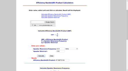

I'd so a single beefy 12 ported if you only have that much space. aeroported as well. Those demons dont do that hot in sealed compared to ported purely from the TS parameters, they have an EBP of 67 which is suited for ported. For sealed performance you want subs that have an EBP of 50ish or less. you are better off getting a single SSA Icon 12 ported in the space and power you have vs trying to put subs in sealed which they were not engineered for.

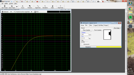

If you really do want SQ over everything a pair of dayton HO 12s in a sealed would work well for SQ. They work in smaller boxes and are geared for linear SQ and musicality but still gives good overall loudness. I'd say they are right in between a JL W3 and W6 in terms of performance.
https://www.parts-express.com/dayton-audio-rss315ho-44-12-reference-ho-dvc-subwoofer--295-467
These?  Would you really build it only .5 cuft each?  That would make things alot easier, just a straight box instead of building to the contours of the trunk.
you have to account for the space the subwoofer takes up as well and the wood thickness but yes this would be the more SQ oriented approach.
i'd do .75  cubes "after sub displacement and wood thickness based on winisd graphs. You'll also need to stuff with polyfill.
