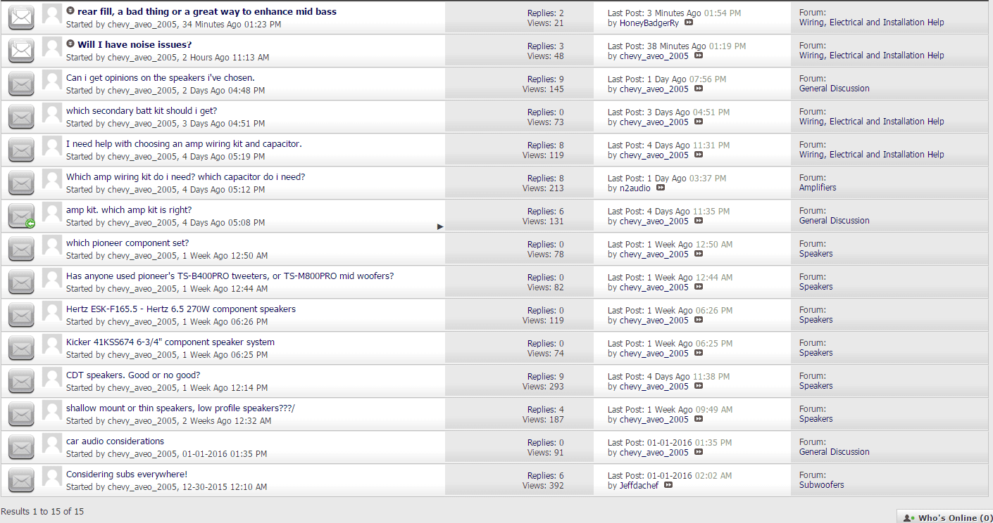

it's time to stop posting new threads, OP.
Let me guess, you were spoon fed from diapers till high school.... another one of these new thread spammers with basic questions that have the same answers all over the worldwide web. We are here help on things you are really stuck at after you doing your own research, not spoonfeed you all the way through.
