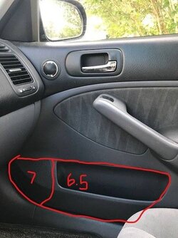

Hey guys, I hope all is well !  I wanted to ask a few more questions before I started on my doors.  I got all my speakers etc in now and was thinking of the best way to do the door pods, I will include a pic and what I am thinking about doing at the moment.  Jeffdachef you had mentioned I should put an actual baffle ( enclosure kind ) on the 6.5" so it would not interfere with the 7" using the door space ( back wave etc ).  I was going to locate the 7" Anarchy in the stock speaker location and the 6.5" a little to the right of it.  With the large pocket area there, I was thinking of just closing up the area inside the pod between the two speakers and using the pocket area as an enclosure for the 6.5" ( cutting the pocket area off of the door panel to make in glass ).  I was not quite sure though on the air space as most door speakers I guess are just meant to work in IB, so was not sure if this was a good idea or not.  Let me know what you guys think and if you have any other suggestions.  I just haven't been able to make a final decision on placement of the speakers yet.  I appreciate!  Oh!  I also got a few goodies for my sub set up as well 😃
i'd do some kick panel enclosures so you can aim the mids on axis or to the center of the car firing up to get the sound stage higher but thats just me.  You can do your idea as long as the mid is isolated completely from the midbass.

Doing the mid range in the kick panels would make doing the door a little easier and it does make sense to have them aiming up.  i would probably get a lot more of the sound from them down there then in the door because of the seat or a passenger sitting there.  Kick panels seem real easy to do as well so I may try that first.  Only thing I was worried about was the airspace in a kick panel enclosure, was not sure if that was really enough room for it to function properly.  I knew I couldn't put the mid bass down there, but with the mid range playing a little higher it should be good?

you dont need airspace at all with the midrange down there, no issues there at all you  can make it as small as needed and use acoustic fill to smooth out midrange response or EQ it out.
