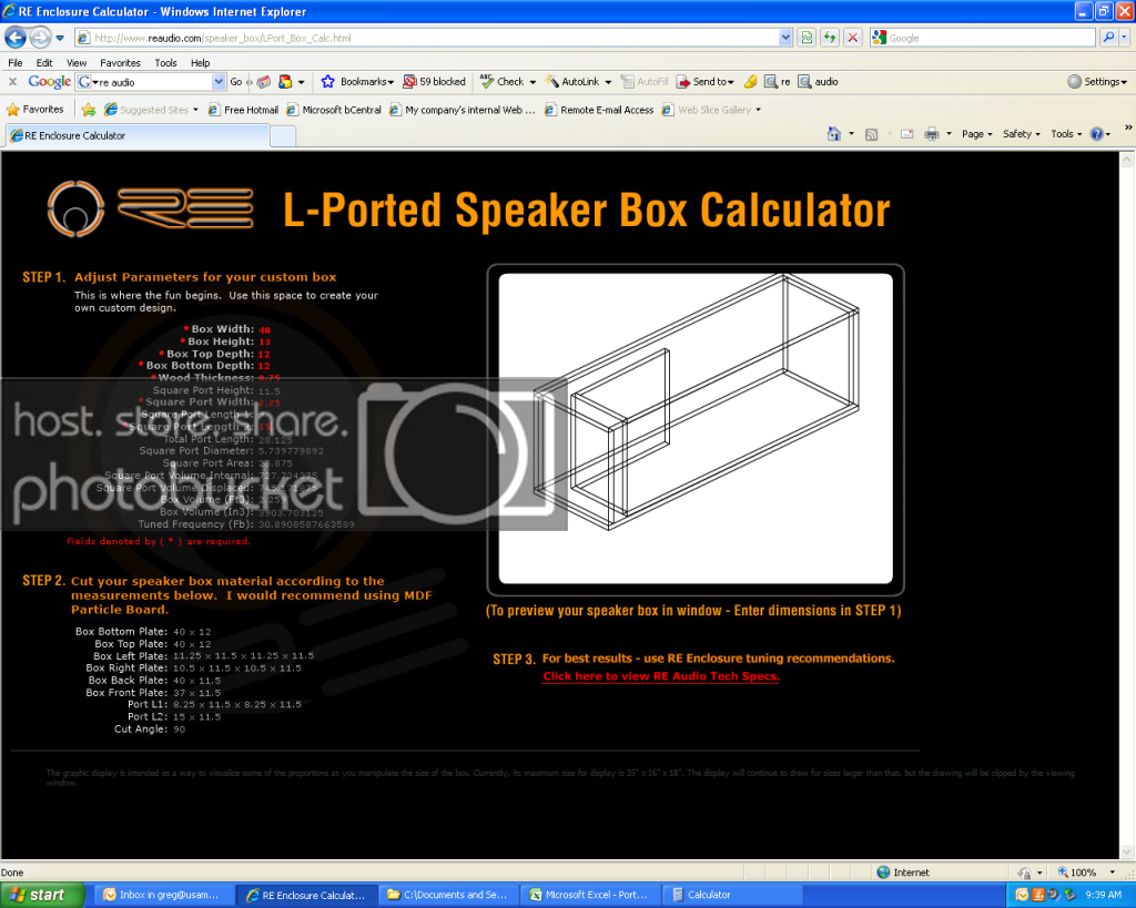

When I called re and spoke to greg about my truck and the space and everything else this is what he emailed me. Sure does look on the small side to me. It's smaller than re spec
see next post

2.25-2.5ft^3 at 32-33hz should work well for the pair...that's probably close to as big of a box as you can get, maybe a little larger...don't think you'll need it though.
Any idea how much port area for the 2- 10's ?
