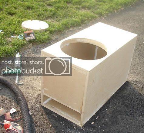

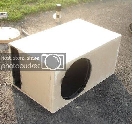

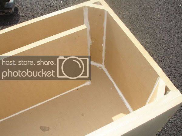

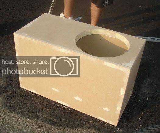

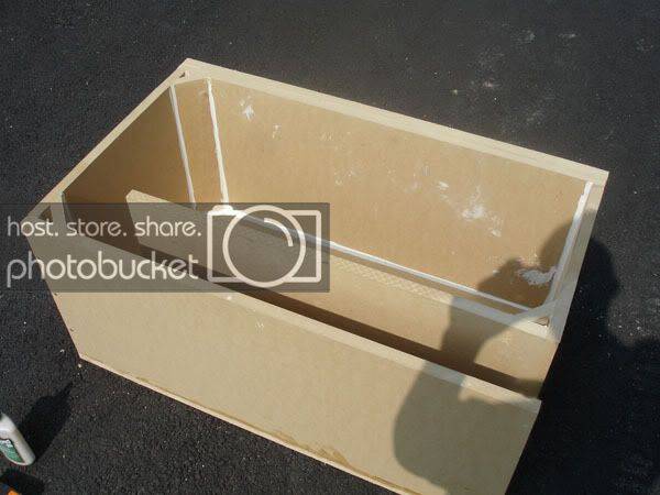

Just finished it up yesterday, sub should be arriving sometime this week.

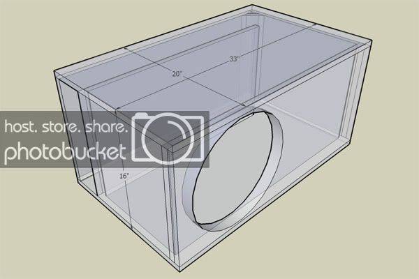

Box is 3.75 @ 34.5hz w/ 58" of port //content.invisioncic.com/y282845/emoticons/biggrin.gif.d71a5d36fcbab170f2364c9f2e3946cb.gif
Going on an American Bass VFL 200.1 so it will be seeing a little over 3,000 watts
car is an 07 honda civic coupe
