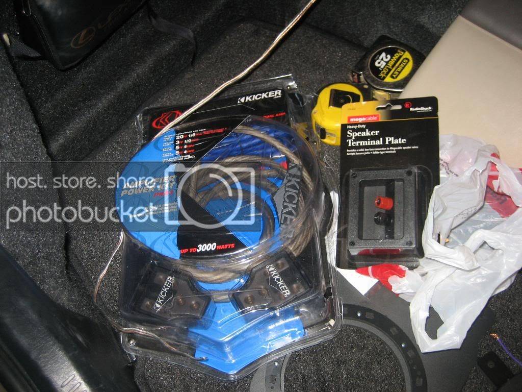

kicker 0 gauge and 4 gague wire. fosgate rca's

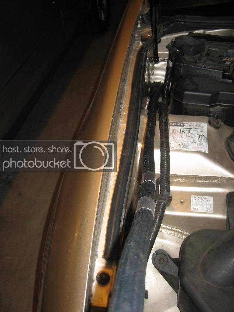

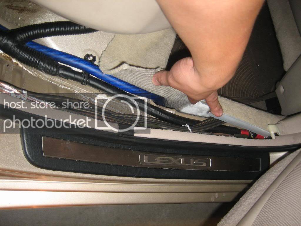

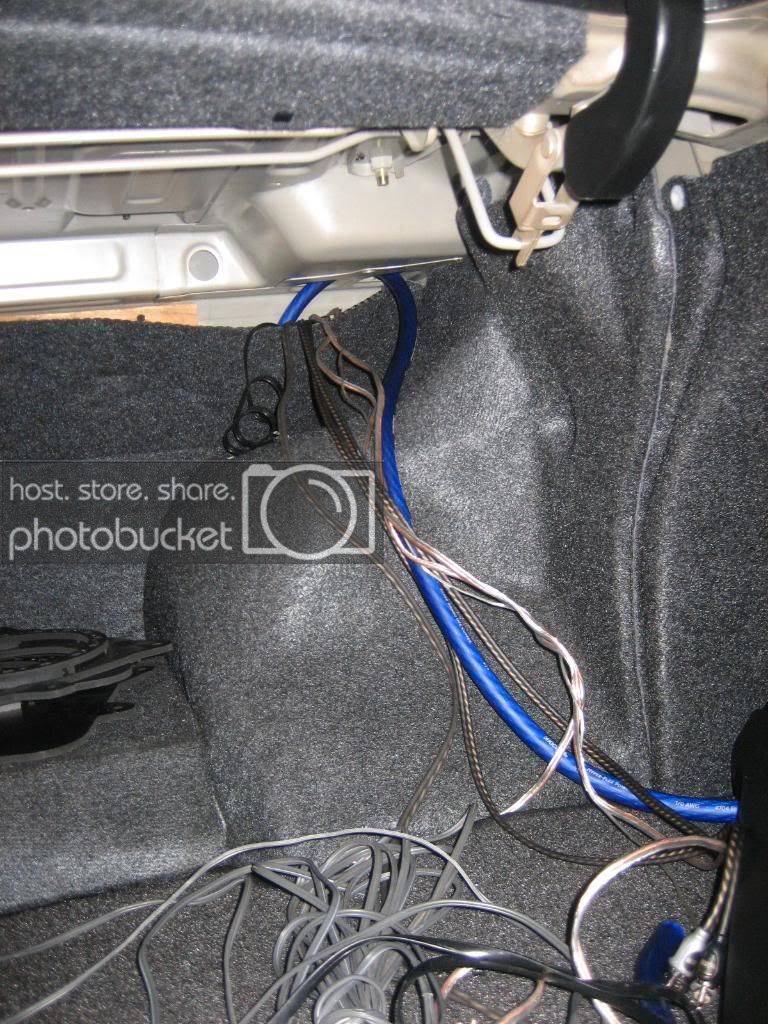

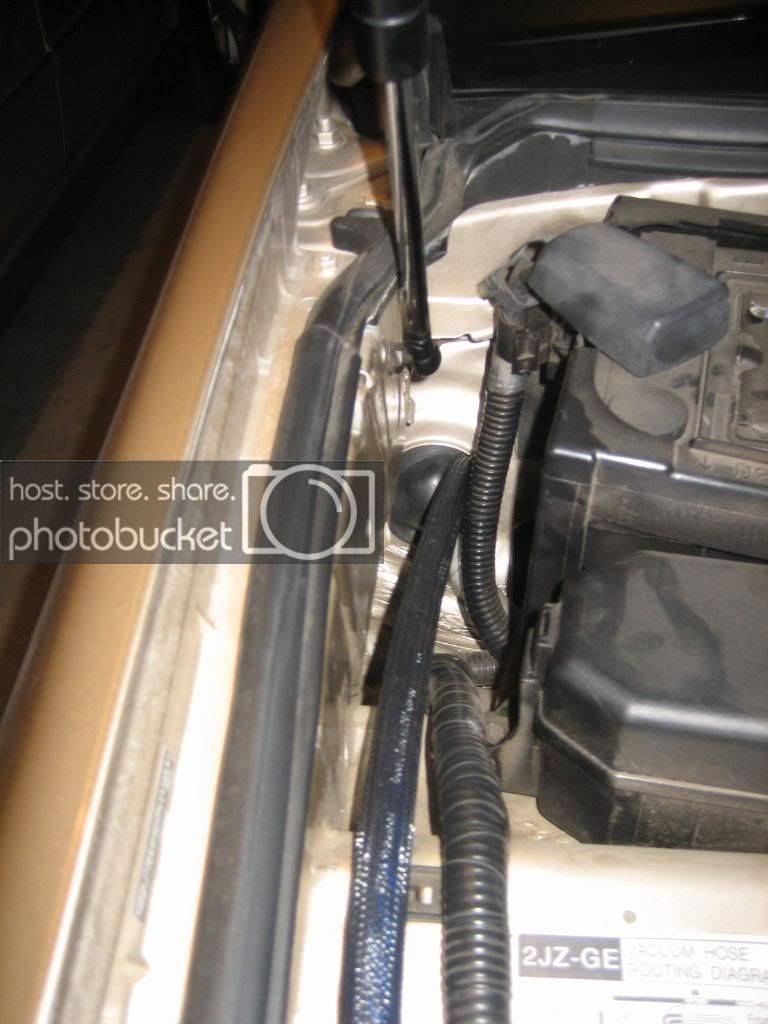

running 0 gauge. wasnt hard. had to run it on same sides as rcas and speaker wire though. good thing is, im not getting any noise from that. running it from front battery under the hood, to the back in trunk.

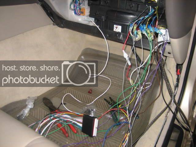

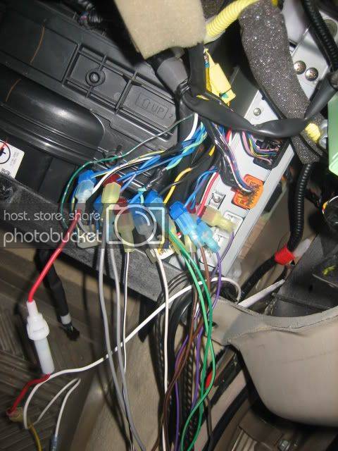

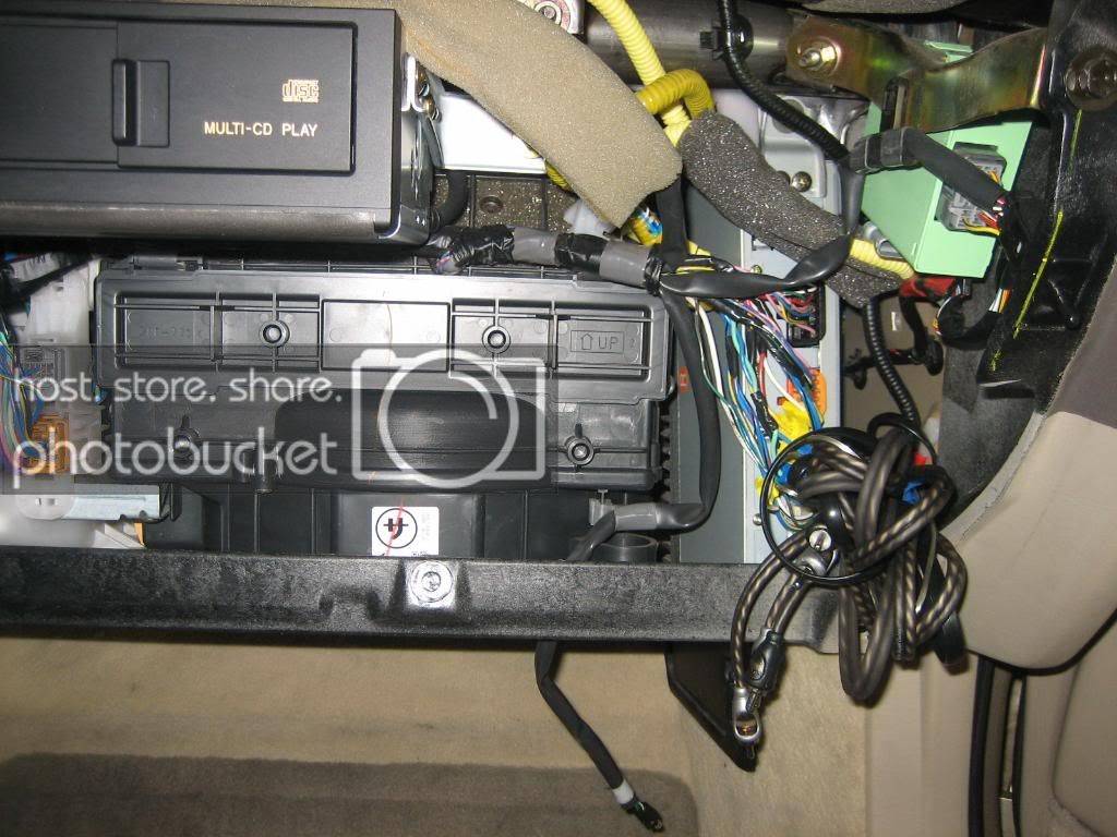

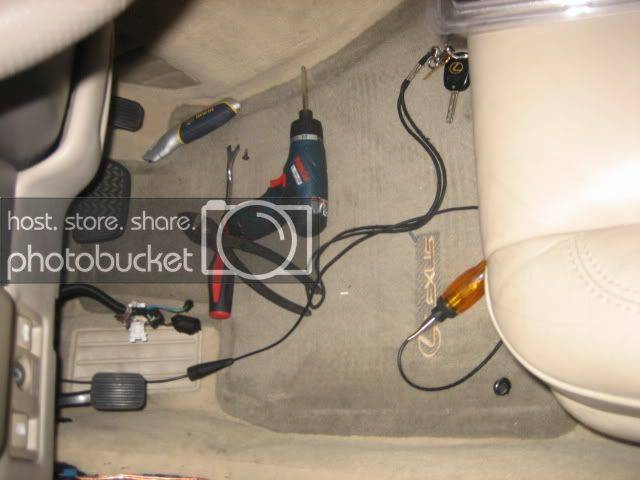

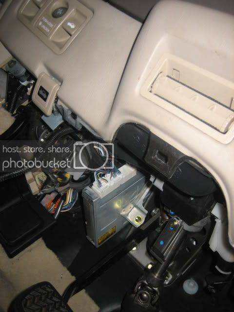

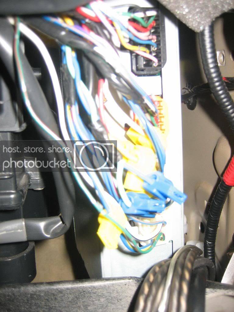

wiring for req5. had to take signal from the factory amp and connect it to the req5 harnest for it to take factory sound and sum it for aftermarket quality sound. sends signal through rcas to amps. the concept of doing this is easy, but it was a different story for me. first i kept getting alot of engine noise. could not get rid of it with everything that i tried! finally figured out connections were too tight! who knows how that happens, but i did rewiring and i fixed that problem.
wiring for req5. had to take signal from the factory amp and connect it to the req5 harnest for it to take factory sound and sum it for aftermarket quality sound. sends signal through rcas to amps. the concept of doing this is easy, but it was a different story for me. first i kept getting alot of engine noise. could not get rid of it with everything that i tried! finally figured out connections were too tight! who knows how that happens, but i did rewiring and i fixed that problem. took ignition signal from key igntion to turn on the req.

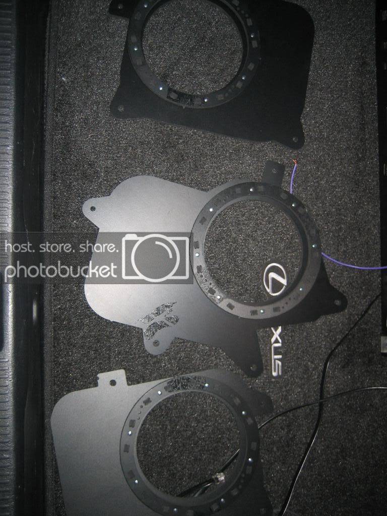

SPEAKERS/ADAPTERS:

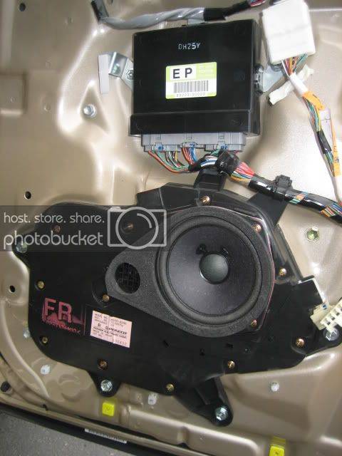

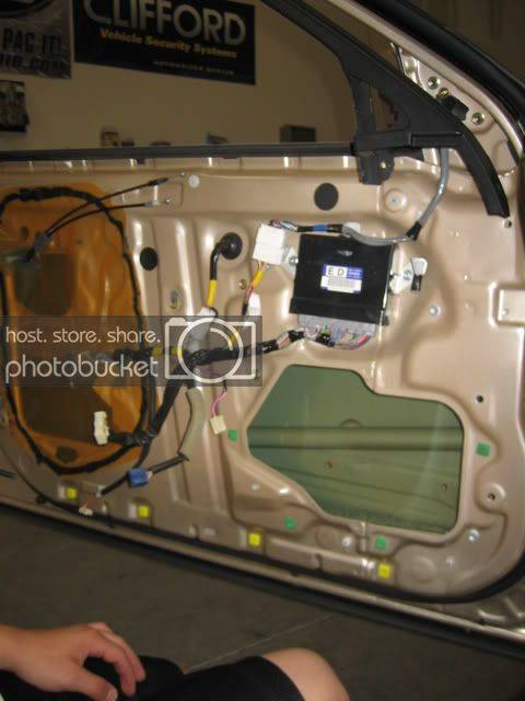

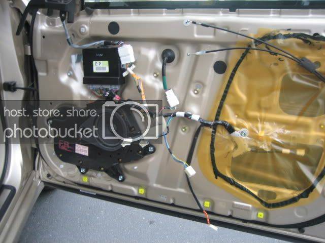

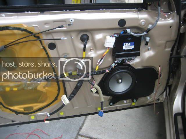

stock speakers/tweeters:
stock out:
adapters in:

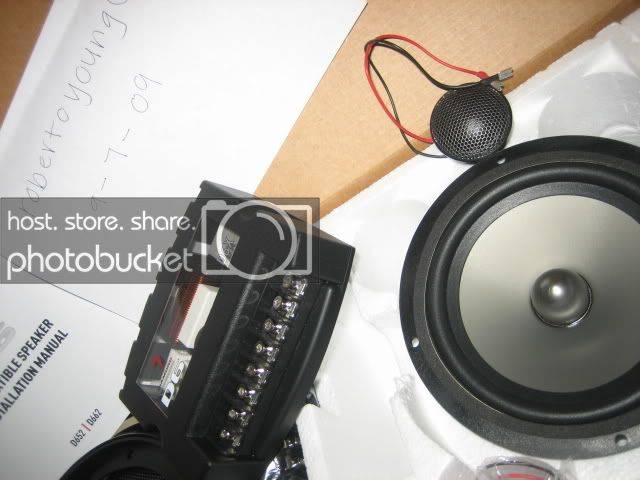

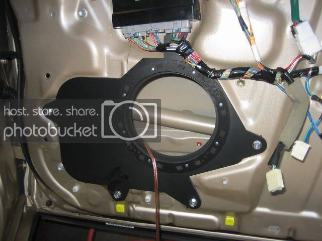

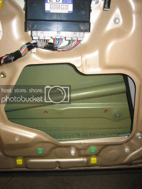

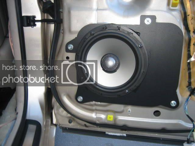

new components in:

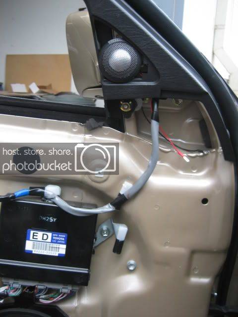

front components:

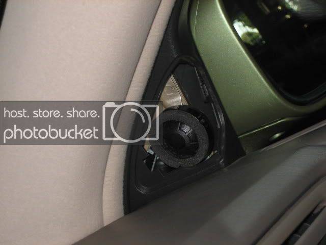

tweetrs:
rear components. my diamond d6's can be mounted as coaxials. so that was real usefull since i dont have any spot in my back doors to mount the tweeters separately. just take off the dust cap and i can mount the tweeters on there with an adapters. was usefull:

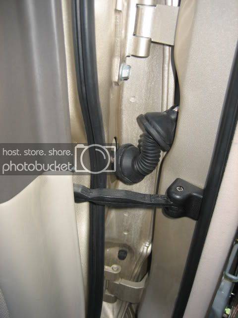

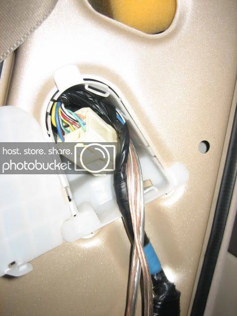

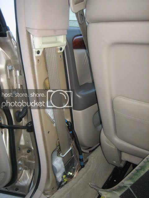

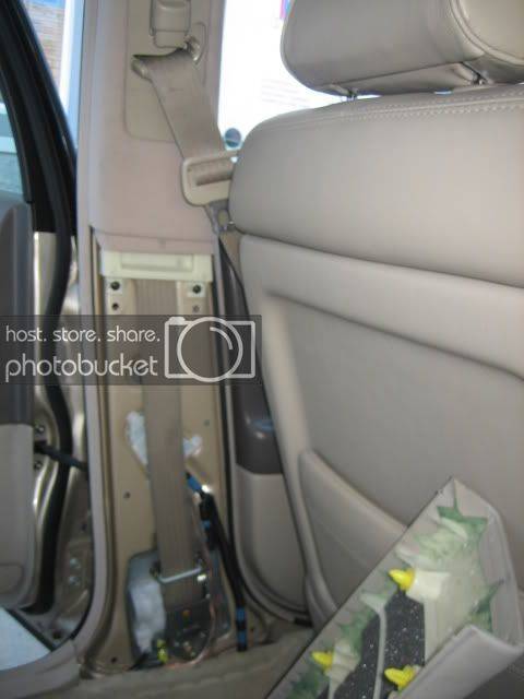

WIRING speaker wire from trunk to the doors. managed to get all speaker wire through the factory protecting sleve things between the doors and the inside of the car. got it all through, so its neat, hidden and protected =)

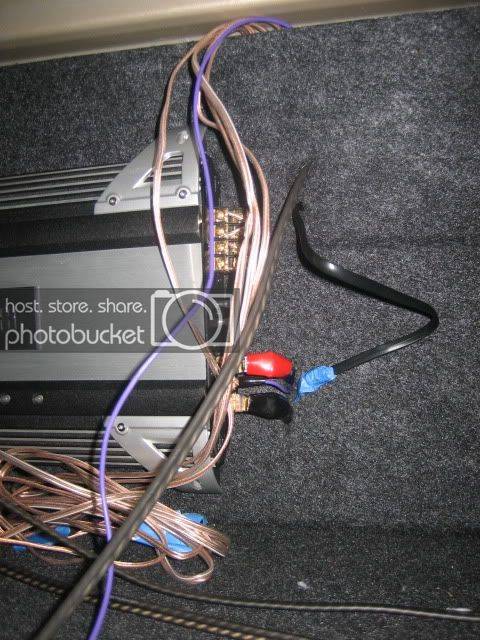

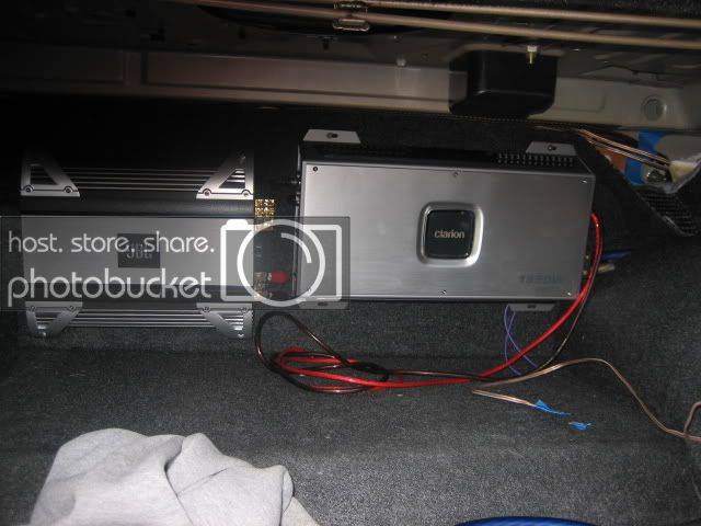

wiring and mounting amps in trunk. was the hardest part for sure! had to mount amps against wall of car and get wiring through the carpet. was by far the hardst thing. being cramped in a trunk and trying to get my hands on all wiring and a good view angle. plus alot of the work was done at night with one flaslight, pretty hard, but i got it done. was worth it. came out alright id say. was real limted to wiring so i had to make every inch work as well as i could. some of the wiring gave me only about an inch or two to work with, and to get them into the amps, including the room it takesfor my fingers to hold the wire plus the way it was all set up, i barely had any room. really frustrating at times, but i finally managed to do it. i better not take out any of that wiring now or it will be even harder to get it all back in next time.

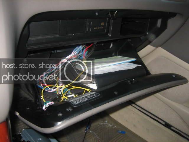

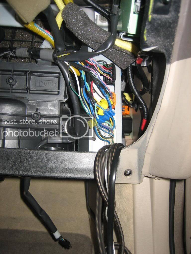

glove compartment where the req5 will go.

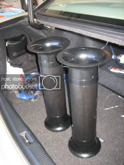

last, here is the box. 3.2 cubes at 35hz. i know, i know. ugly paint coating. but its just temporary until i get the box carpeted. hopefully il get to it soon. paint was just leftover paint to cover the wood for now. carpet coming soon.
