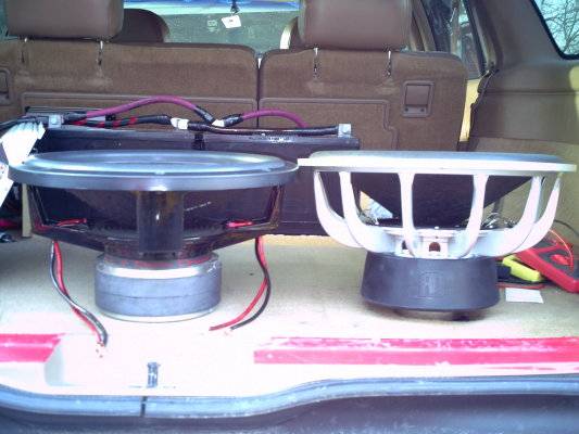

Compared to a DD 3515.

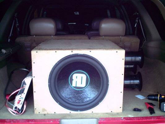

I started out with 2.5 cu. ft. box after displacement and 2 4" external aeroports tuned to about 60 hz. Powering this setup was 1 PA 3000db at 1 ohm.
On the TL with a little tweaking I was able to get a 145.5 out of this setup. Mind you this is MECA style at the head.

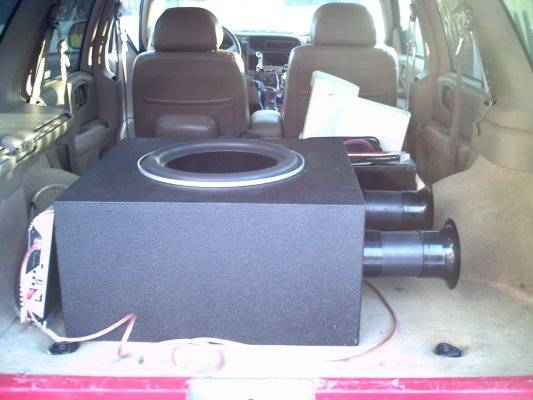

Next setup was 3.9 cubes after displacement and 3 4" external aeroports tuned to about 50hz. With the same amount of power.
With this same box I added another amp to strap 2 PA 3000's at 1 ohm.
