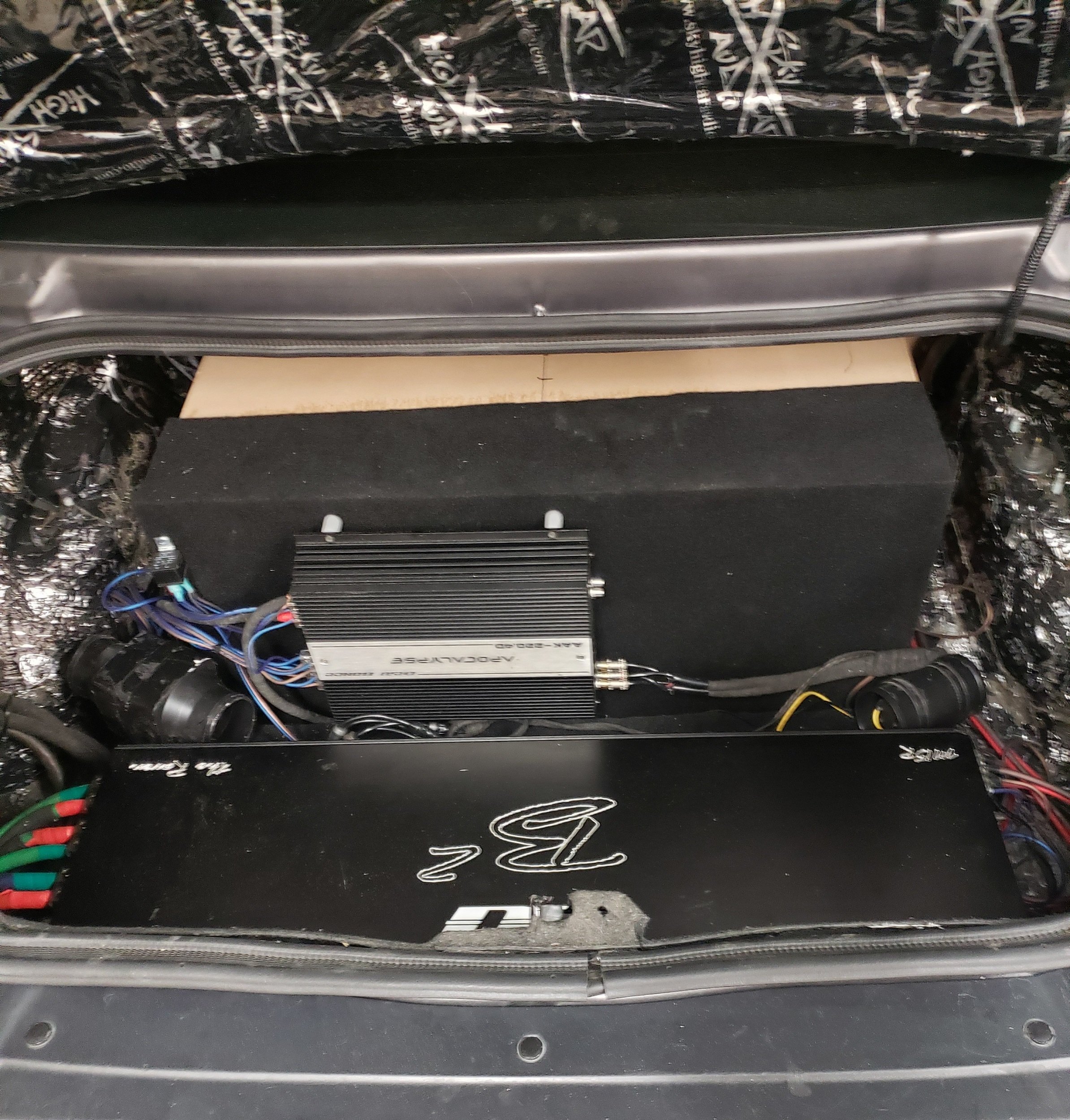

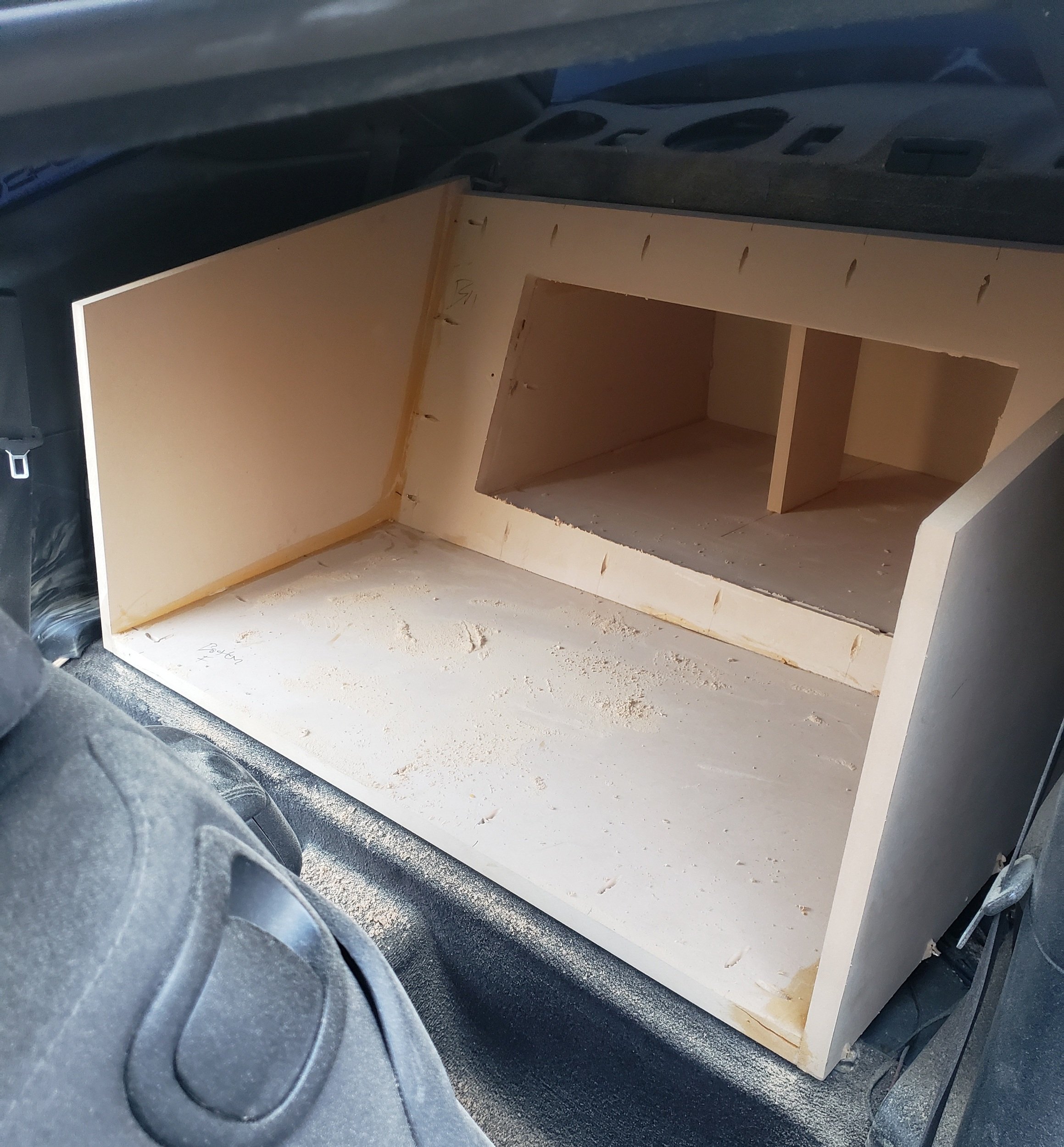

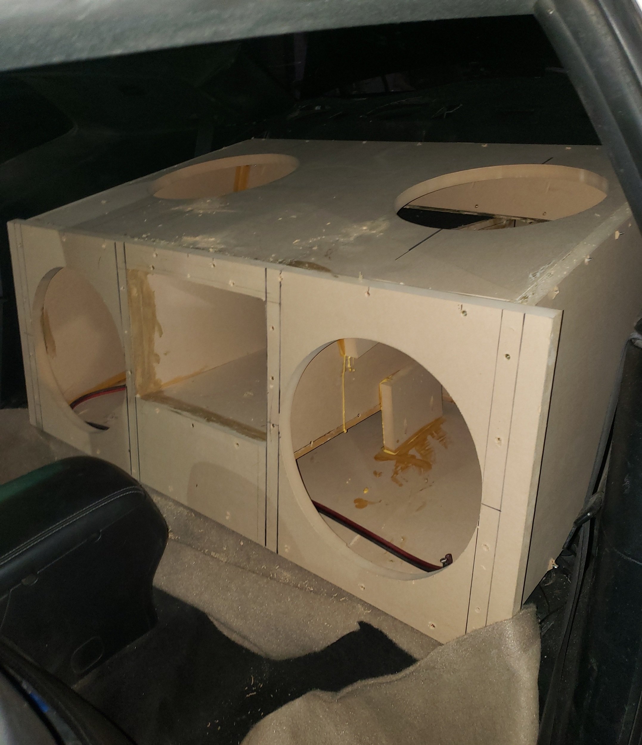

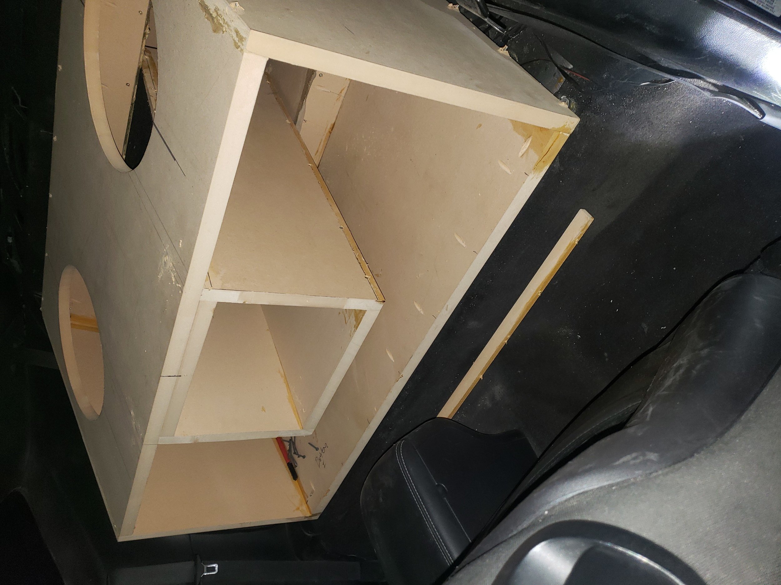

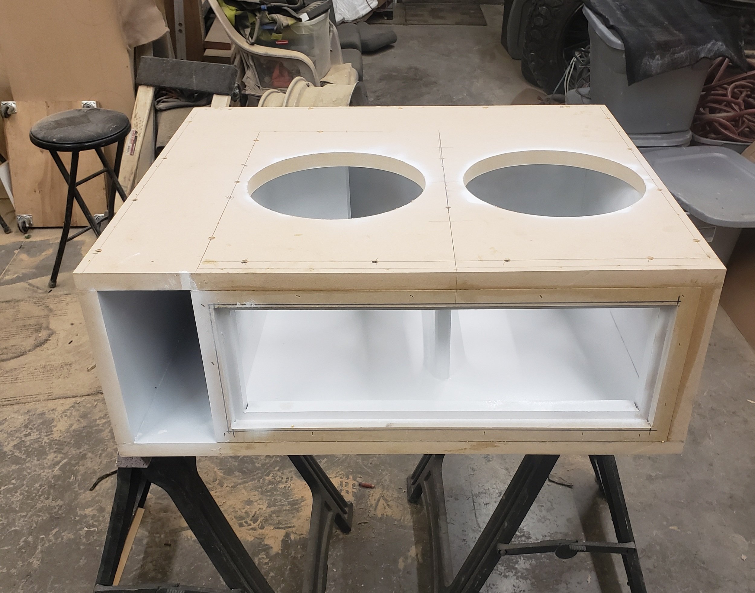

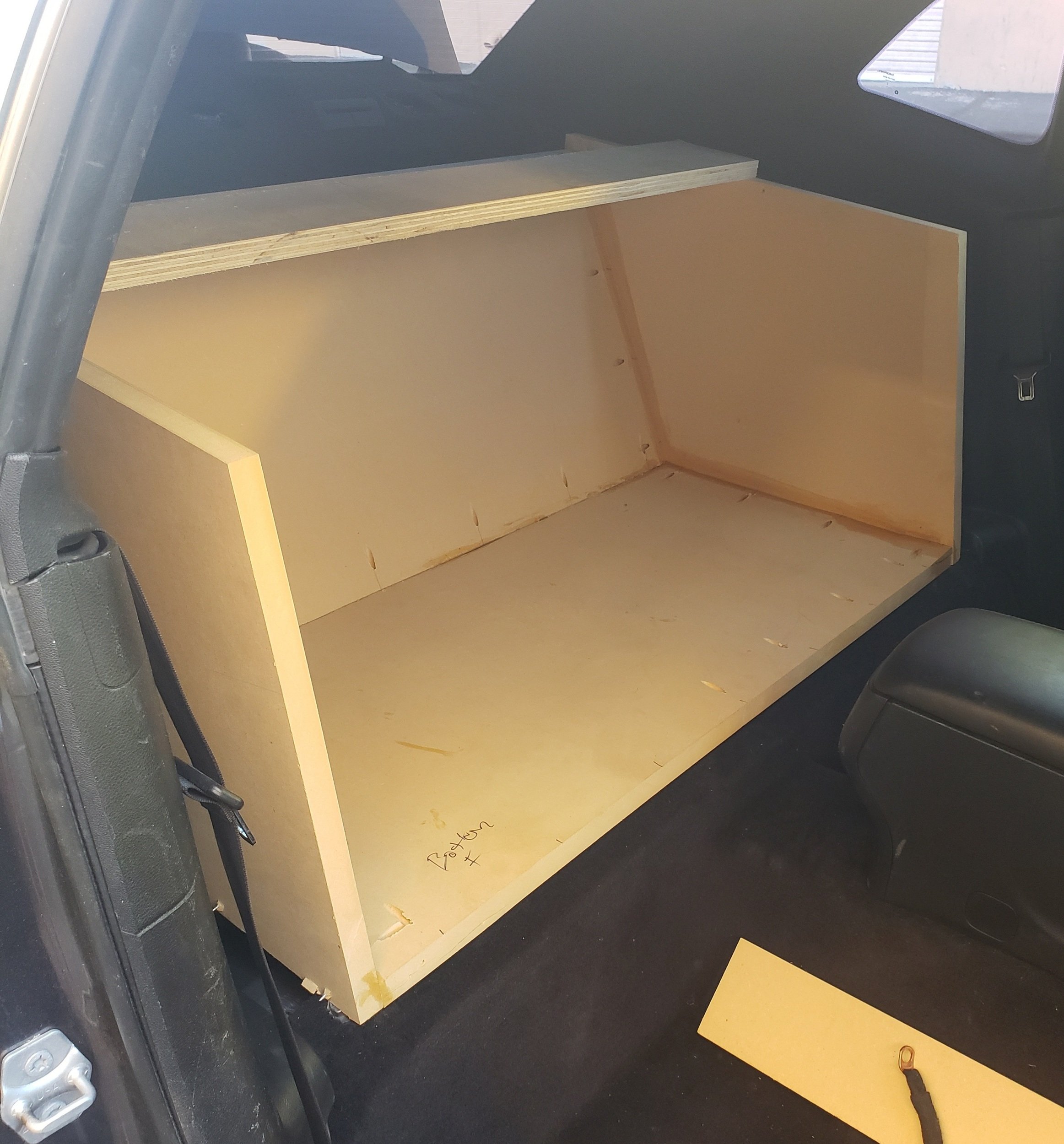

4 - 15" Sundown U series subs in a Challenger Scat Pack. The box is roughly 14 cubes net tuned to 29hz. with 149 sq. inches of port. They are powered by a B2 Raven (M15r) wired to .5 ohm. I understand that this probably isn't the site for this kind of stuff anymore so feel free to leave your political opinion.

my political opinion is I would of went 2 15’s in a wall and definitely would of got the hellcat instead 😂.

I'm not a wall fan. 4 - 15's is a lot of cone area and that B2 Raven is a 15,000 watt amp @ 1 ohm. The Charger Hellcat is next in line.
when you sacrifice the back seats, might as well go wall lol. That’s just me tho.
Then you can't see behind you and that really succks. 4 - 15's in a non-wall sounds cool.

we got cameras for that now 😂. I lucked out cause my car has the factory screen so im gonna have the camera on a switch so if I want I can use it on the fly while driving. Will I use it? Probably not lol. In that setup tho he has the box going partially in the back and kinda sealing it off so I’d guess it wouldn’t have output loss. I wanted the trunk free in my setup so I can lay everything out all nice with plenty of room.

He drove up from Arizona to have his box built. He slept in the shop one night. He was upgrading from 2 - 15's. He already split the metal on the corner of the sunroof. He's running the factory in dash HU and an external single din. It's kind of a weird HU setup. That amp is pricey ($3K).
It's hilarious how somebody actually posts a real life build and people will avoid it like the plague. It just proves how fringe Car Audio is these days.
I’ve flexed roofs like that with a single 15 on 1200 watts, heck slugs truck does it with the sub I built him lol. It’s not easy to gauge from a video but I will say it definitely looks nice! On a setup like that with 15,000w and 4 15’s I’d hope that thing would at least do mid 150’s on a meter and if it did that or higher, I’d be impressed. Lower I wouldn’t be, happy I touched it 😂. I would of touched it sooner but the video wasn’t working earlier ☹️.
It's probably in the are of 155 - 157. He is still breaking in the subs right now. It's definitely a beast for a no wall.
