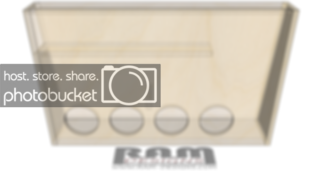

Four SA-8's in 2.75ft^3 with a 33hz tuning.
Ram...not to be a nay-sayer,but based on delay group...how do these 4-8's load in-vehicle?
It seems that the farthest sub is at least 36" from the interior of the vent, and the closest is ~12"...????
What vehicle was this design for?
Ram...not to be a nay-sayer,but based on delay group...how do these 4-8's load in-vehicle?It seems that the farthest sub is at least 36" from the interior of the vent, and the closest is ~12"...????
This is going in a Suburban. The port actually ends just a few inches off center from between the two middle subs(you can see the vertical line at the very right of the right sub cutout.
