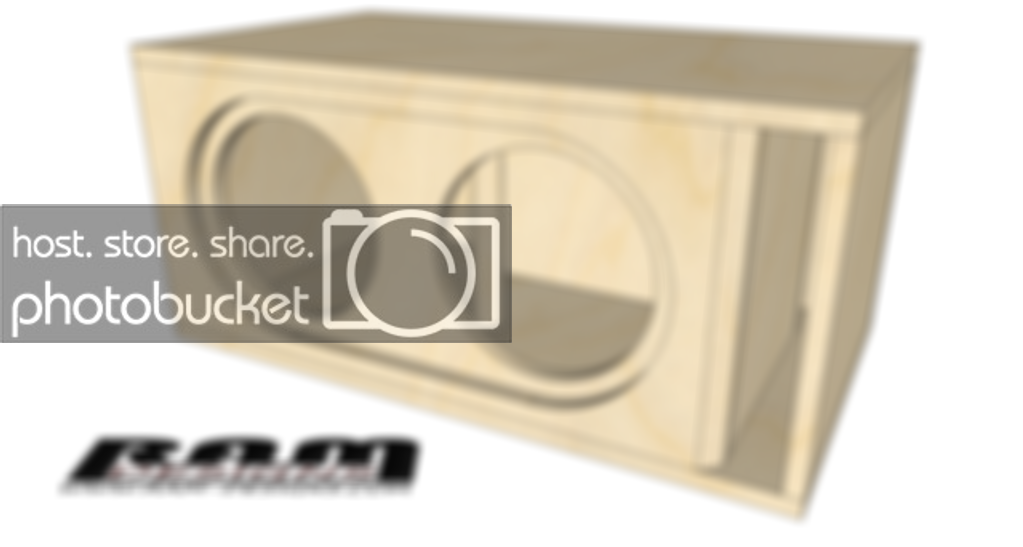

1.4ft^3 at 32hz for a pair of SA-8's.

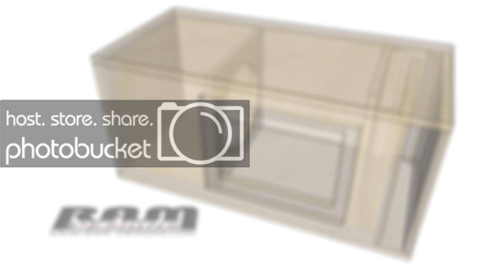

4ft^3 with a 34hz tuning for a pair of Fusion 12's...had to do this one in metric units, which as you can imagine was a ton of fun.
fusions ****!!! i had a pair of those fusion encounter 12''s on a rf power 300.1 amp and they sounded like trash! it was even a custom box. i cant remember what it was or any measurements but it was for the subs. and they hated it!

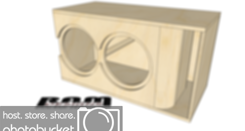

Box for Mitchell Collins down in Aussie land. The box is for a Phoenix Gold 10" sub, .8ft^3 sealed firing into 1.15ft^3 tuned to 44hz. Anechoic response is +-2.5db from 30-70hz with a beefy low-end, just what he was looking for. As you can see there is a recessed area for some plexiglass. This will also serve to remove the sub if needed.

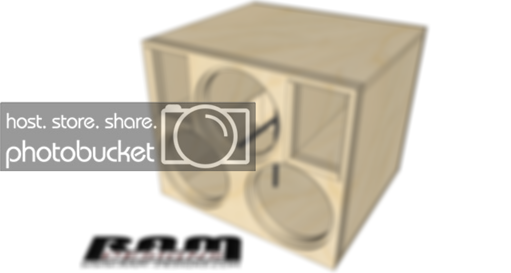

Three 18's, 18ft^3 tuned to 32hz...poor Explorer. //content.invisioncic.com/y282845/emoticons/biggrin.gif.d71a5d36fcbab170f2364c9f2e3946cb.gif

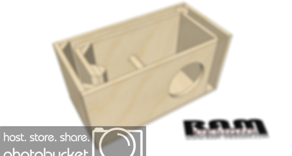

Here's a fun little ported box for Blove1995 on here. .8ft^3 with a 32hz tuning for his Cadence CVL-8.
these three designs are ON POINT, I think from an aesthetic point of view you've come a long way and your designs are getting more and more complex.
edit: realized i sounded like i was kinda talking down, not trying to, just complimenting //content.invisioncic.com/y282845/emoticons/biggrin.gif.d71a5d36fcbab170f2364c9f2e3946cb.gif
