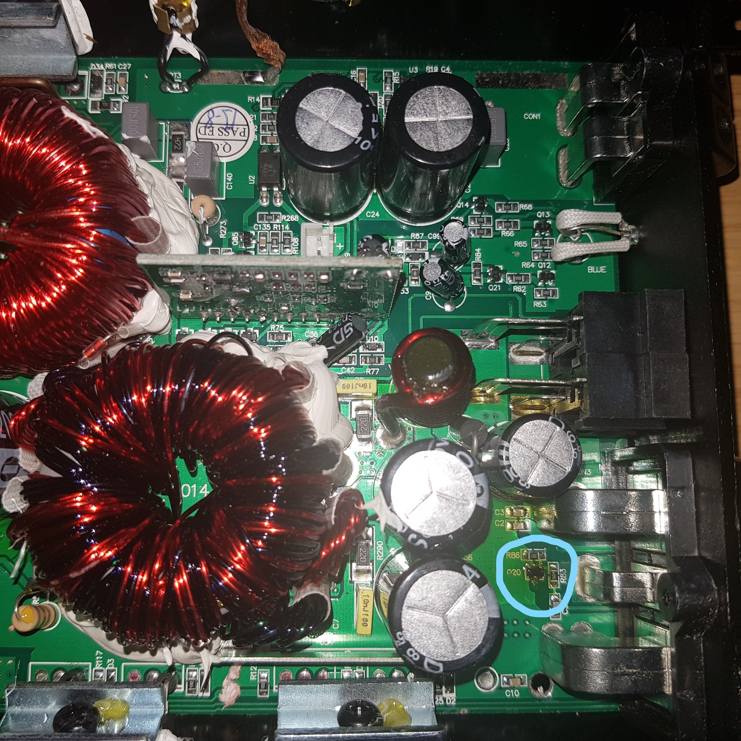

Rainbow Dream 1 amplifier going into protection mode, burning fuses
It seems like the amp is blown and there's a short somewhere inside. That's the only reason the fuses would blow immediately like that, from what I know.
Indeed, but finding out the cause of it is what I'd like to do, if possible. I have a digital multimeter so I can try probe some things if you or anyone else reading this has any suggestions.
I'm pretty sure those two donut coils should look exactly the same. How many channels is this amp?
It's a mono amp so 1 channel (sub only amp).

Isn't that a blown resistor of some type
32154
As far as I can tell, no. If you are referring to the yellowing, it is soaked with the same yellow gel along with many other parts of the board. I could try draw an outline of all the parts that are covered in that yellow stuff if it would help.

Sounds like it was installer error. More than likely power touched ground damaging Power supply.. Just my 2 cents.. Or could have ran it it a lower ohm load and damaged some Caps, and or Mosfets. About all I can think of. But Fuses not popping as they should when in contact with supply generally tells me.. Power Supply issue.. Power and Ground met at one point and damaged power supply(Installation Error/ Rookie)

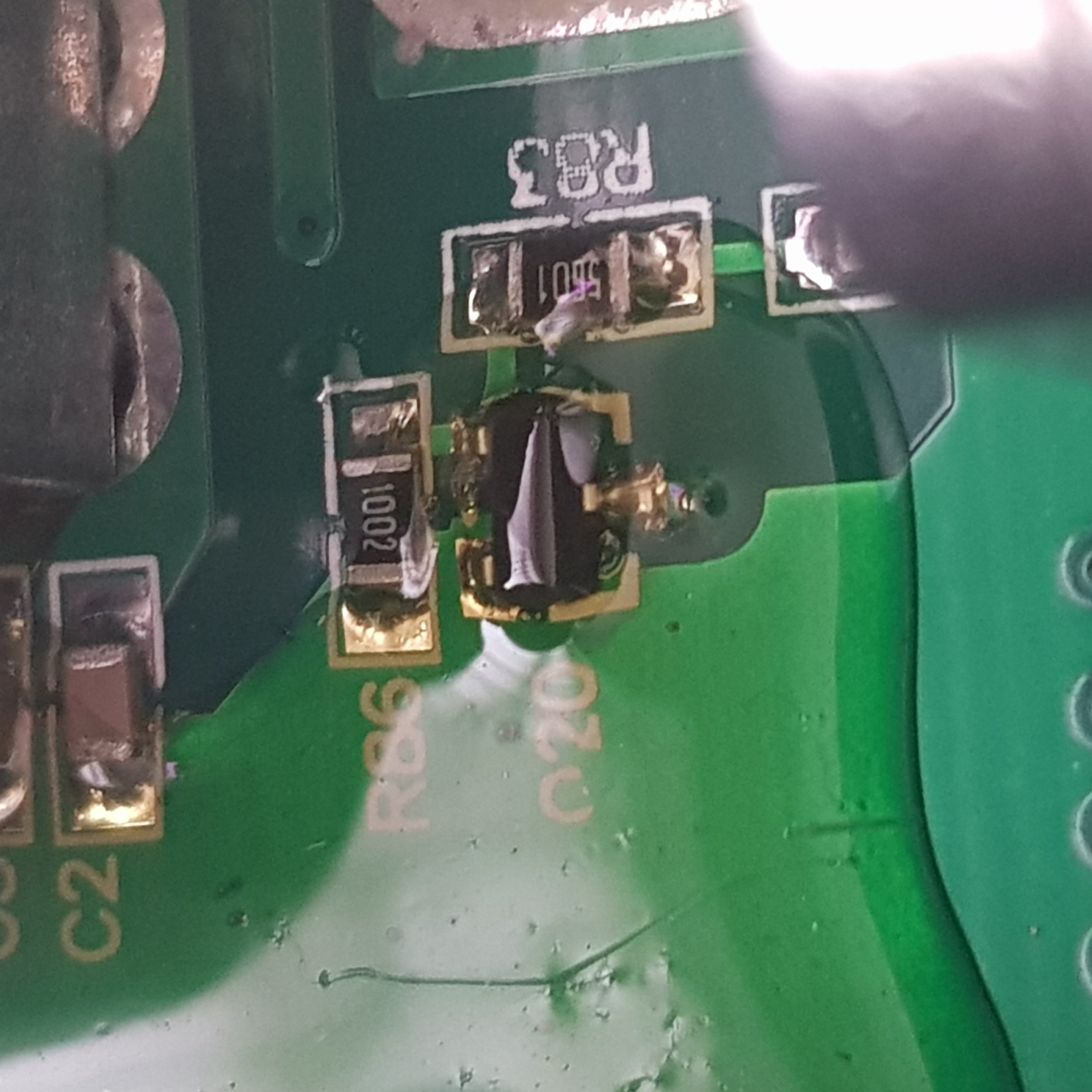

No, if you look at R86 and R83 you can see the resistor. But on that one Q20 it is solid black. Look at Q21.
Might be, in that case. I'm still not entirely convinced though. I had as close of a look as I could at it but it doesn't look damaged in any way. I think the yellow gel might have possibly eaten away at the text on it though (if there were any on it in the first place).
32159
Although something very odd I have noticed is that C7 is basically just a melted spot with no tracks. I wonder what in the world that could be (or what it was).

I know im late but did you check the bottom part of the board maybe burnt tracks. I recently resolderd a visonik that looked perfect untill i flipped it over and a giant ground rail on the board just missing a chunk. I think the dude just over powered your amp (why the gain is all the way up) and the coils unless you can wiggle them they should be good. Some caps even though they look good could be exploded. Only way to test would be to lut fuses on it and power it on but first flip over and inspect that side first
