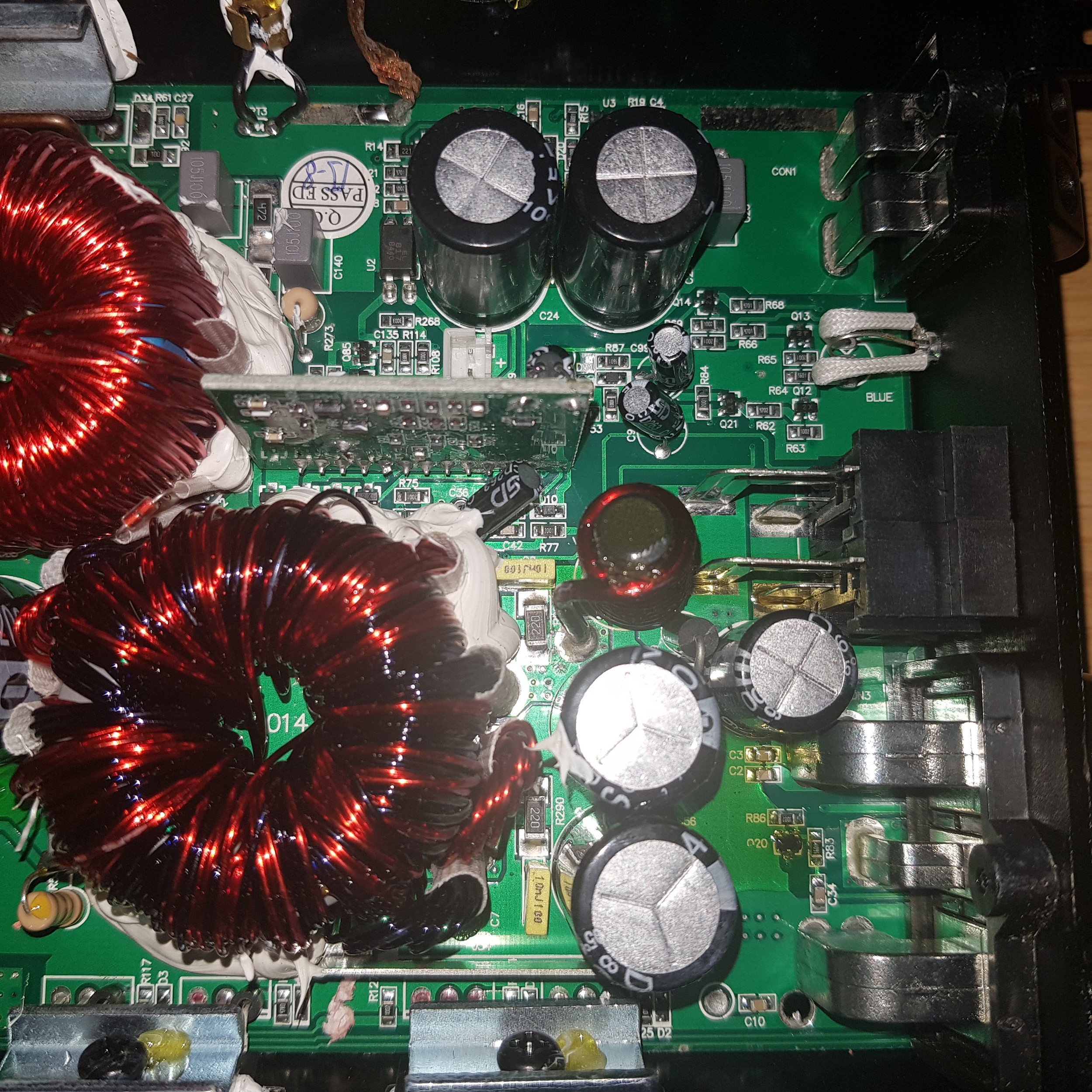

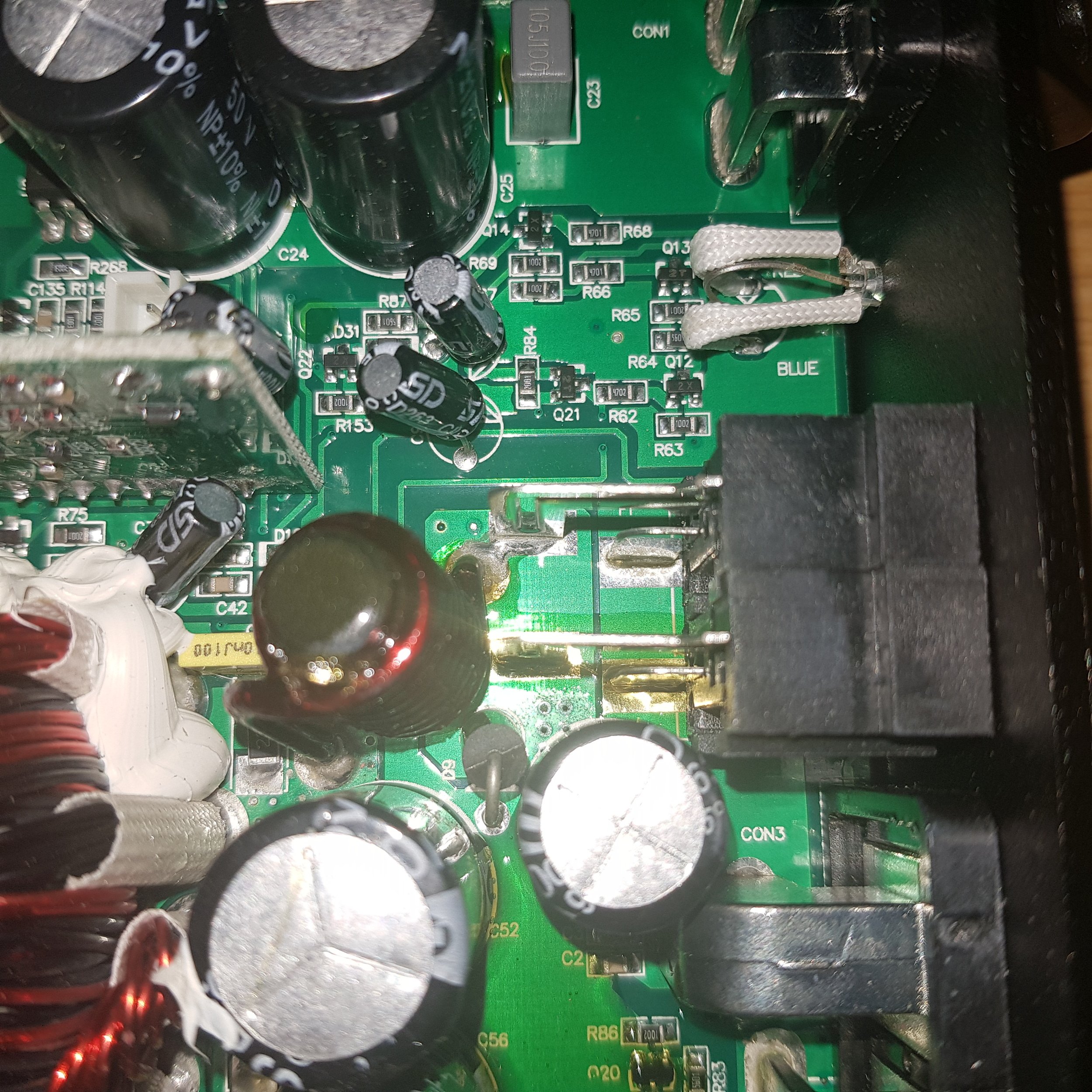

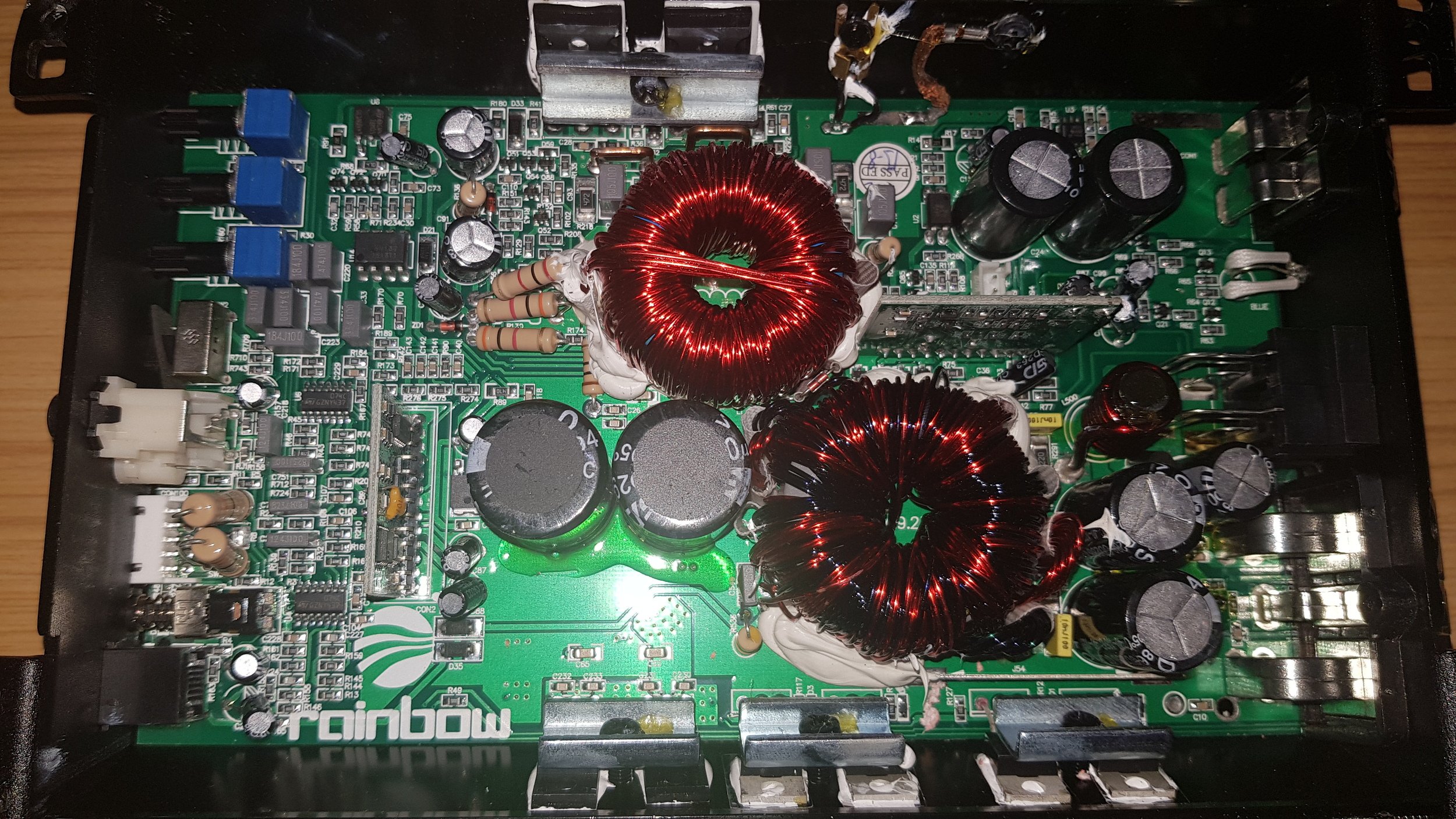

Luckily I just finished opening it up and inspecting it 👍
I'll attach the photos below but I can't really find anything out of the ordinary. There's some yellow solid gel underneath some of the capacitors which has me concerned, especially as it's over a lot of the other components and the fuse connections but it could also be normal?
Again I'm not 100% sure what I'm looking for but I can't see any burnt/blown components of any kind. The last 2 photos are to show the yellow gel that's gone over to the fuse connections, and also the burnt fuse slots because why not I guess :cool:

Do you see the metal there on the "top" fuse bar where it's close to that wrapped coil? You see how that top one looks like a different color than the other bars there? One looks copper-ish (bottom one), and the top one looks more raw silver-y metal-like.
Where that coil end goes into the board, and where the top long fuse bar goes into the coil there; is that metal looking stuff supposed to be on top of the board there? I'm not sure if that metal there is supposed to connect to the end of that coil like it is, but idk.
Just look at the plating on the metal bars that lead into the fuse clips-they seem to be different colors. That could indicate damage, or it could just be the angle of the pics. I am not an amp repair man by any means, but there does seem to be discoloration there between the bars that lead to the fuses, which could indicate a heat related problem, like a short.
I wonder if that is silver solder that got too hot and melted to connect that coil to the top fuse bar or if that's how it's supposed to be connected.
All of the goo on the inside of this amp seems kind of strange. I've never seen so much stuff in between parts and the board itself.
One of those giant donut shaped copper coils looks damaged. Just saw that. Look at the top copper coil, and then look at the bottom one. It's half-black and looks like it's coming apart.

I think the yellow gel everywhere is normal, because I noticed that same gel seems to be on the screws and on some resistors as well. I don't think anything would have leaked because the amp has always been installed upright (the components shown in the photo would have been facing down, so if anything leaked, it would surely go onto the plate that covers this board?
As for the metal bars on the fuses, I think one of them looks discoloured because the gel is also covering the two bottom fuse bars.
I think the coils on the bottom 'donut' are meant to be black. Looking at a photo of the only Rainbow amplifier I can find opened, these ones appear to have black ones too: https://www.amp-performance.de/cach...rainbow/rainbow-kw4150/gal_0/dscf0026_107.jpg
I can definitely see that it looks like it's coming apart though. Assuming this is the issue, what would you think the cause of that would be? I'd hate to know now that the buyer probably abused it because, well, I already refunded them 😳
