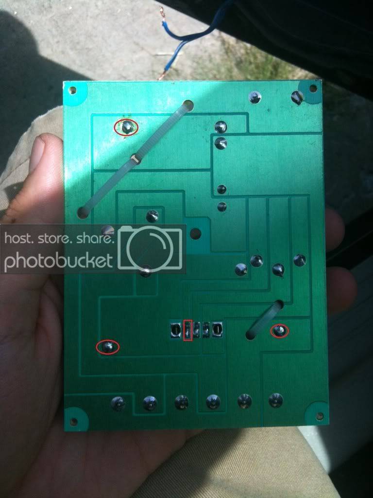

I would re solder all the connections on the X-over first. I had a similar issue with a Bravox X-over and that fixed my issue.
this is the x-over from my bravox, I resoldered all the points on the PCB
thanks for the pic. considering the seller says he will replace I will leave it for now and get the replacement and hope it resolves the issue.
