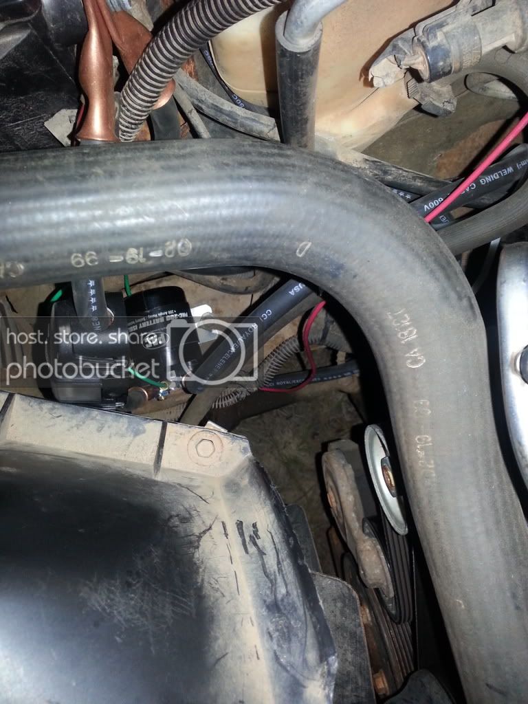

The best thing when useing any multi battery set up is a relay. I have a pissy battery on my truck so i did the big 3, ran a wire from the stock batt. to a 250a fuse then to the relay, ran a wire from relay to battery in the back. Then to the amp. Doing it this way the two batteries are only connected when the motor is on. So u dont have that weaker battery pulling the good one down. I know people just hard wire them together but i dont like doing it like that.

Found a pic of the relay for ya.
