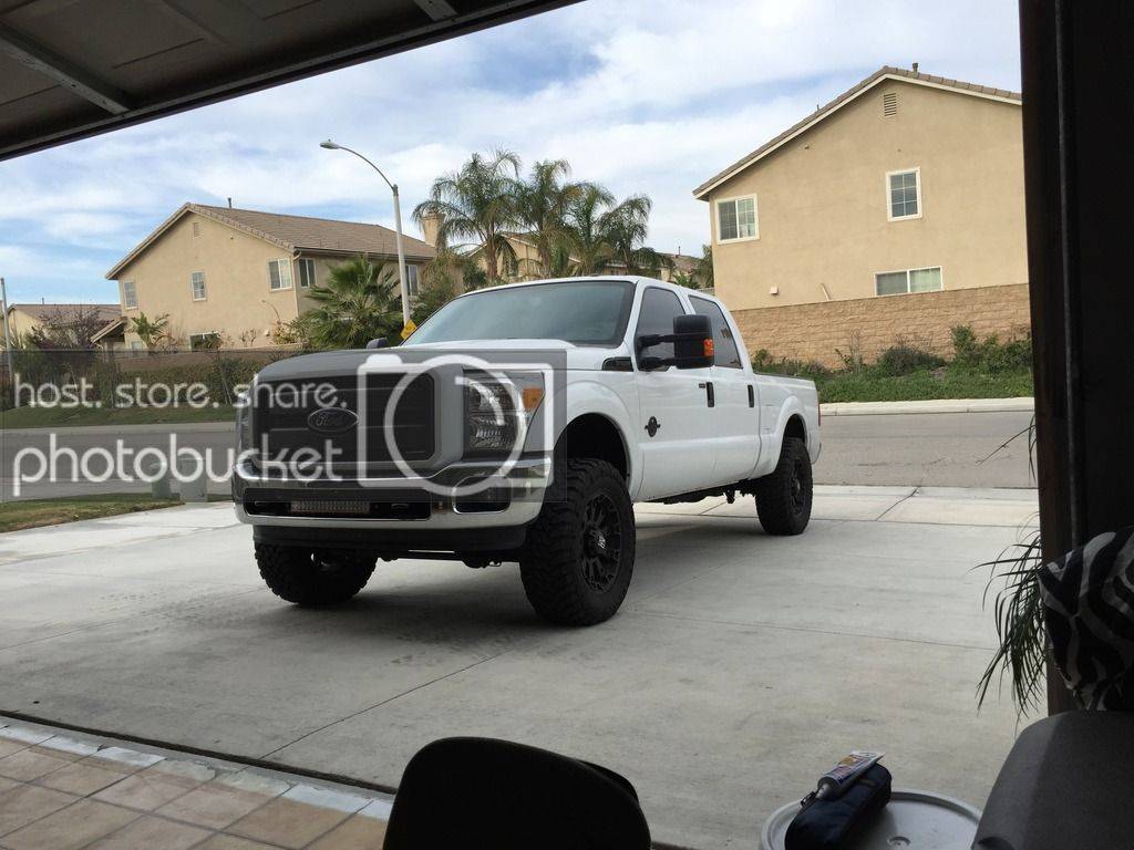

Ok so The truck is a 2015 f250 diesel. It's a towing monster, but the stereo is lacking big time. It's an xlt, so no upgraded factory stereo or nav. However it does have Fords Sync, which works pretty good compared to aftermarket radio bluetooth I've used jn the past.
