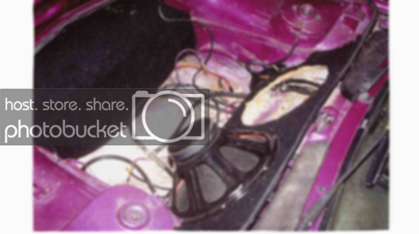

Hey i dont know how profecient you are with moving engine / under hood parts around, but this is what I did to my Fiat rear engine car, and had a trunk up front very similar to the MR2. Maybe it can give you some ideas....or at least thats the idea of my post.
The black area on the top pic is just carpet, under that is the radiator.
You can see the baffle I made, with polyfoam sealant to do the corners and then I just carpeted over all that. DId 145 db at waco autorama back in 1995, which was pretty good for back then, and being free air.
in the pic above, excuse the mess, I was installing hydraulics so I had alot of the interior out...You can see the baffle I made, with polyfoam sealant to do the corners and then I just carpeted over all that. DId 145 db at waco autorama back in 1995, which was pretty good for back then, and being free air.

that wiring scares me.
