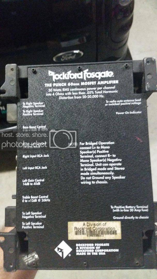

hey guys, I'm Ryan, new here, but been browsing for a few days... anyway, I need some assistance with my amp. I've had it for a number of years, used it to push two 15" Kicker Golds back in high school, and it was a great little amp! I can't remember exactly when it stopped working, but the power light comes on, but the amp puts no sound out at all... is it fixable or should I toss it? Thanks in advance
Ryan
Do not toss it. These are still sought after amplifiers. Definitely make sure the crossover card is plugged in correctly (if equipped) and also check the rca connectors. Don't see many of them with broken connections on these amps but its worth a look. Power is cheap these days so it may not be cost effective for you to repair the amp if it is defective unless you really love it. You could easily sell this on ebay or here (to me!) even if it doesn't work.
Do the rca inputs feel loose at all? Can you jiggle the barrel of the rca connector and get intermittent sound? Positive the gains are not cranked all the way down? Try setting them in their middle positions just to be sure.

Is there an external fuse mounted near that amp going to it? If so, make sure it is not grounding out some how. Frayed wire touching ground or...
