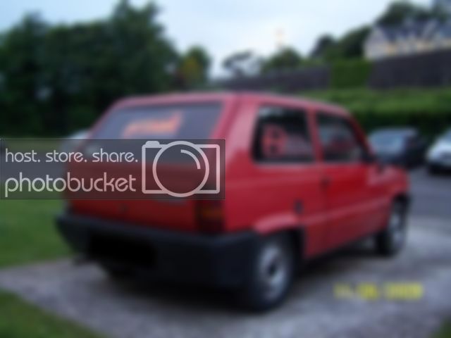

Project PANDBASSA
Car is ready for testing, only have to find a place lol as my lovely neighbors complained to my landlord about the mega heavy noise //content.invisioncic.com/y282845/emoticons/biggrin.gif.d71a5d36fcbab170f2364c9f2e3946cb.gif

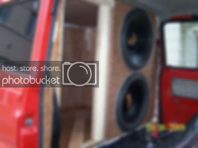

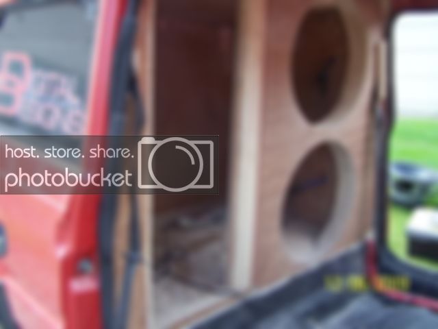

And see if you can separate the back wall from the box, make it movable, this is a good trick, put it inch by inch closer to the front baffle, you will see a gain.

Well. thanx for your optimism lol, but 160 seems to be too far for me lol Really cant see 3-4 db gain here yet ...
Same time if you move the back wall, that makes the box much smaller ... or ...
Box was really weak, but i have a feeling already, before the next test, that its still weak //content.invisioncic.com/y282845/emoticons/biggrin.gif.d71a5d36fcbab170f2364c9f2e3946cb.gif
The BEST thing here is that, ive learnt alot with my own experiences, it IS totally different to read and dream or to build and get something ...
So really m,any thanks for your help guys, who knows, maybe 1 day il be in your class //content.invisioncic.com/y282845/emoticons/tongue.gif.6130eb82179565f6db8d26d6001dcd24.gif
160 is not that hard on this car, is very easy, you just need to do things strong. Please, if you dont get a good result on the testing try to put that back wall closer to the baffle.

Like i said few times before, the car will get removable port and will be mainly a streetbasser like she was already !
