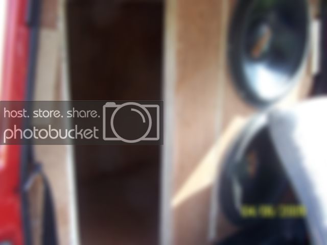

Box is peaking on 78hz ...
Didnt expect that ...
Yes that what i did with the port, made it as wide as possible and also calculated with BBP and got port tuning 64hz with the program ffs lol
Dont ask plz, the score was pure shait ... ok, around 30 degrees celsius as well in the car, but still ... seems i have to make the port smaller now
So around 17.4 cf box
port height 34.45 inch
what should be the width //content.invisioncic.com/y282845/emoticons/confused.gif.e820e0216602db4765798ac39d28caa9.gif
Double checked again and got 64hz tuning again on BBP //content.invisioncic.com/y282845/emoticons/rolleyes.gif.c1fef805e9d1464d377451cd5bc18bfb.gif
Whats wrong ?
So far : things getting more weird for me ...
Made the port smaller, peaks between 68-70hz ...
car is same hot as yesterday and batteries charged, 154.8 when i was in ...
154.4 when out ...
wtf is wrong there ? ? ?
At the end of the day got 155.5 @ 68hz, similar with previous box ... removed the sunvisors, put the dynamat on few holes ... charged the batteries again ...
And i dont get wtf is wrong there ...
what is the thickness of the baffle? You need to round that.
its 50mm, 2" ...
i will round that but i cant believe theres 3-4 db behind that ... //content.invisioncic.com/y282845/emoticons/rolleyes.gif.c1fef805e9d1464d377451cd5bc18bfb.gif
