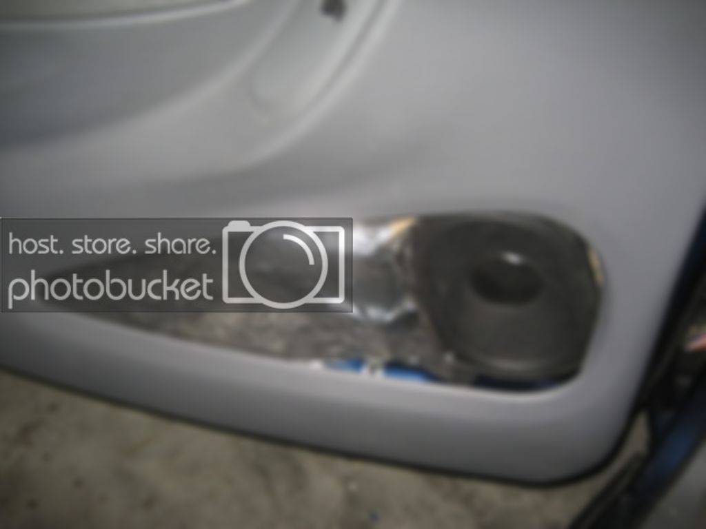

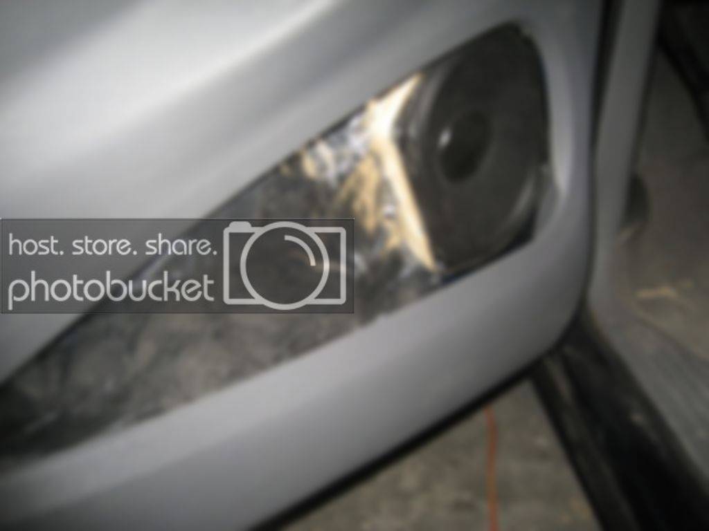

Well, I got after the drivers' door today, and got the midbass remounted on 1" of MDF. The window now goes down, and the midbass does not rattle the panel. I must say.... mounting it on MDF made my midbass sound like straight up subs... and that's with just one side done. It got a bunch louder. I should get metered with just my doors //content.invisioncic.com/y282845/emoticons/laugh.gif.48439b2acf2cfca21620f01e7f77d1e4.gif
don't worry, it won't look like that for long //content.invisioncic.com/y282845/emoticons/smile.gif.1ebc41e1811405b213edfc4622c41e27.gif Grille cloth and vinyl will make it look nice //content.invisioncic.com/y282845/emoticons/smile.gif.1ebc41e1811405b213edfc4622c41e27.gif
