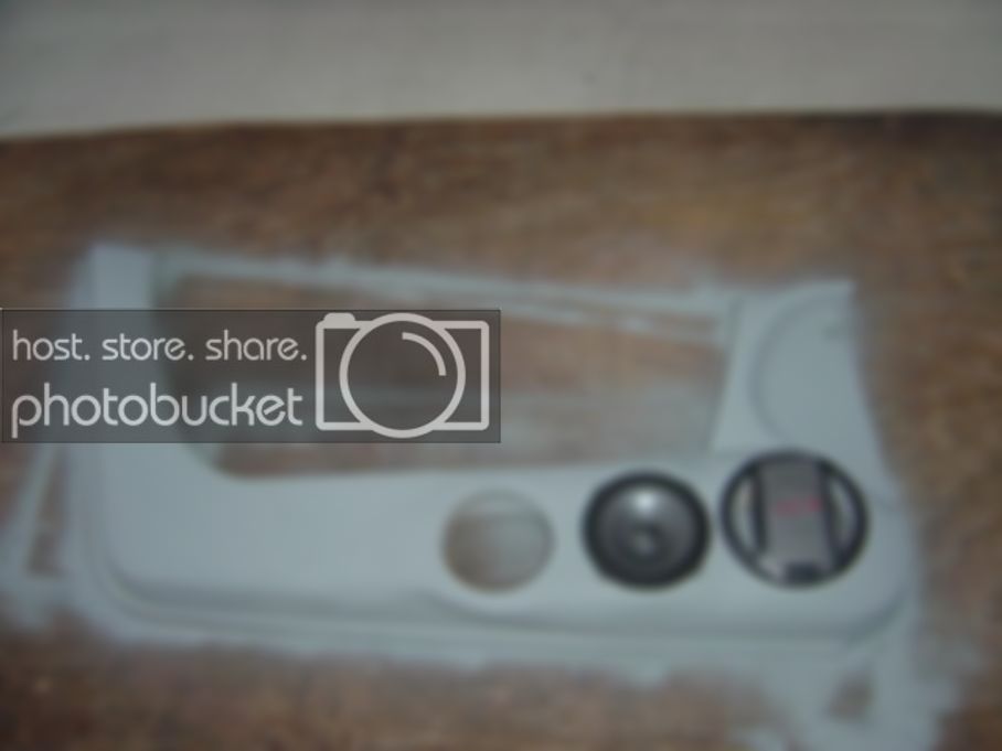

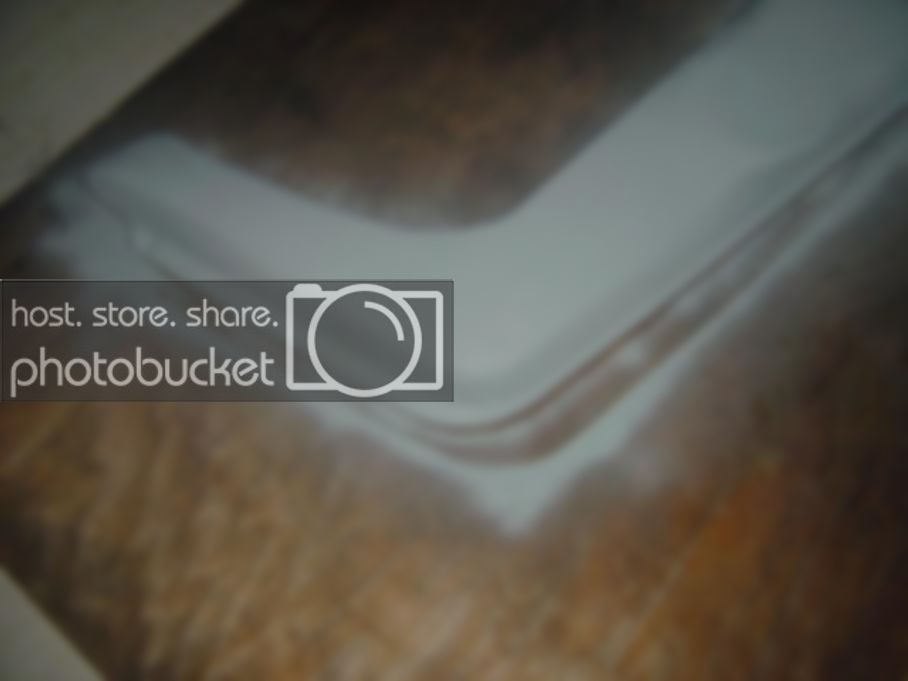

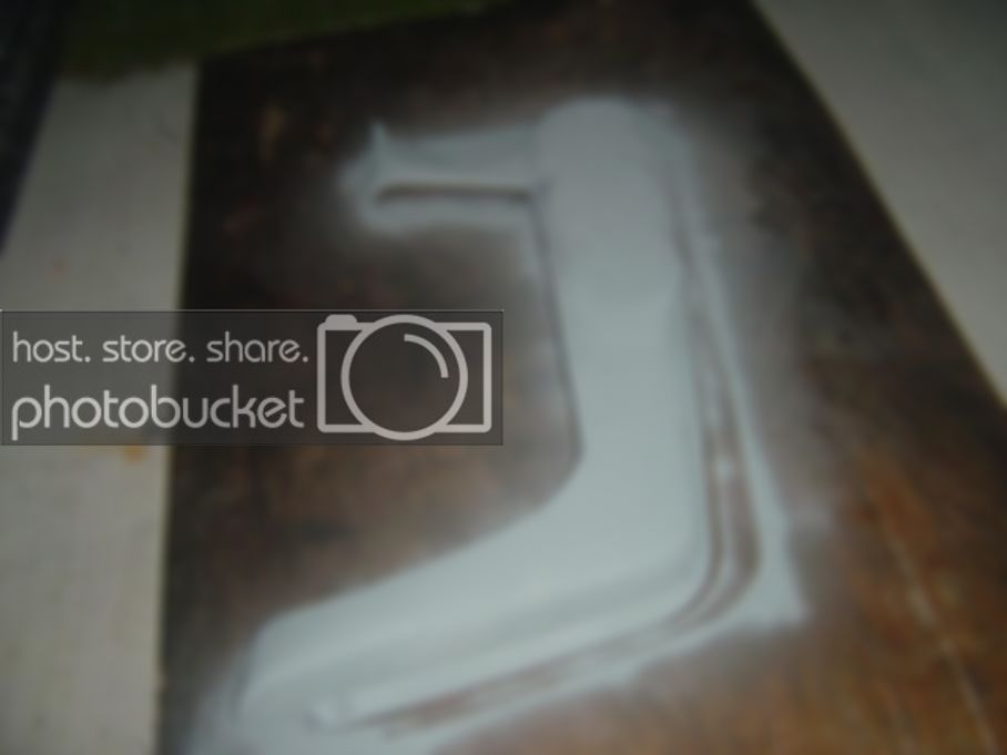

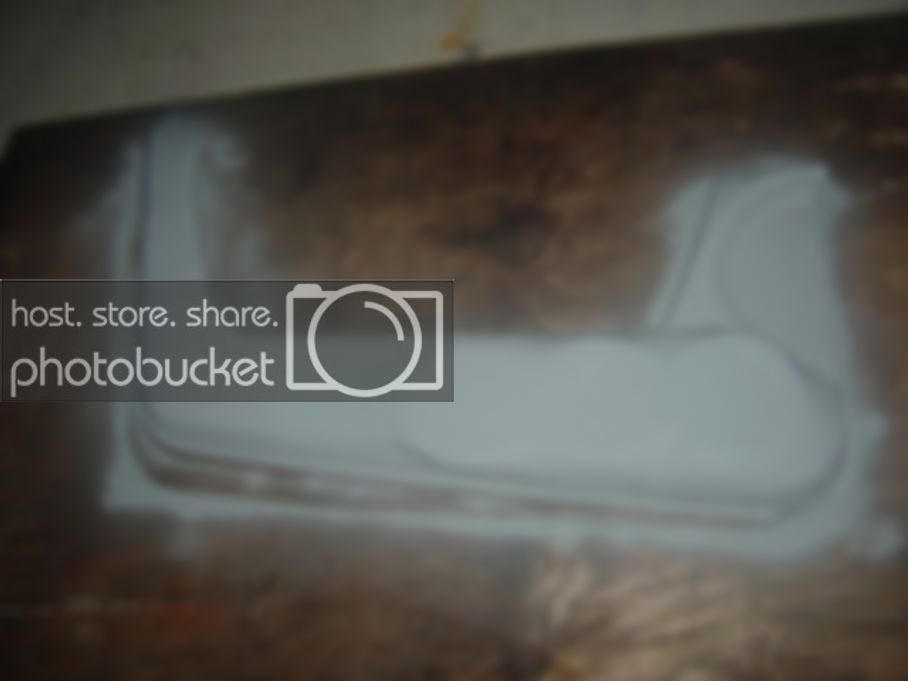

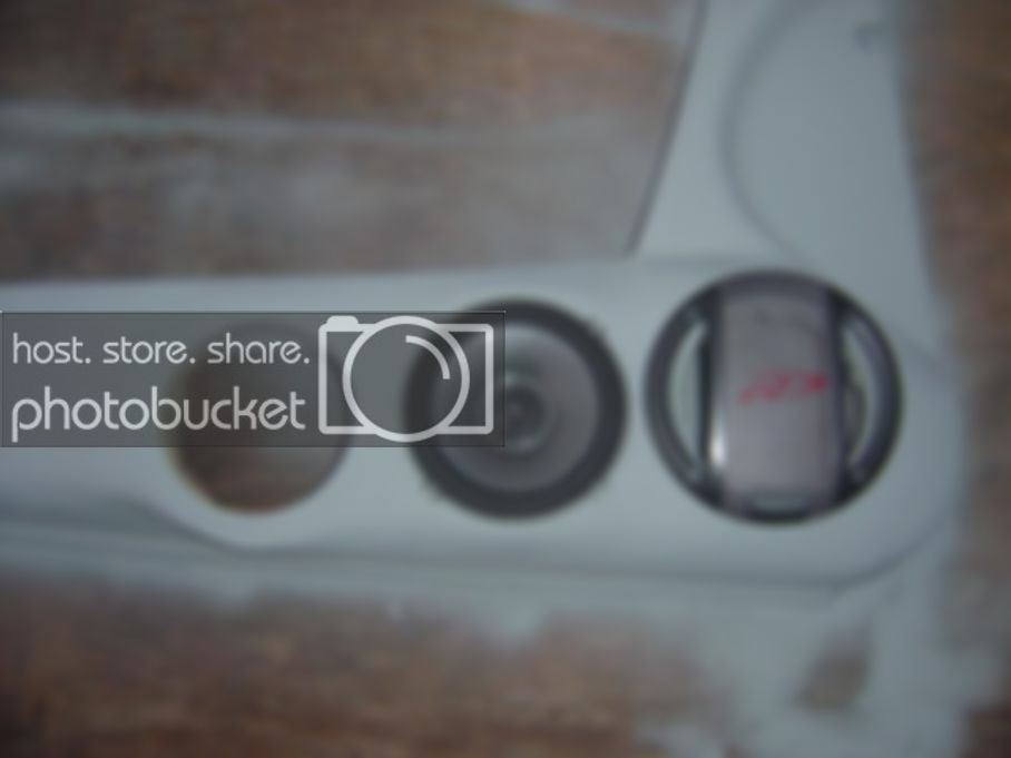

I was going to primer the doors today, but a storm was right on top of me and was getting ready to rain.
