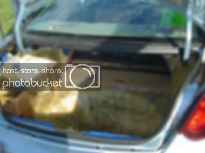

I've pre-ordered the subwoofers, I will get them near the end of may/ early june.
This is the stratus:

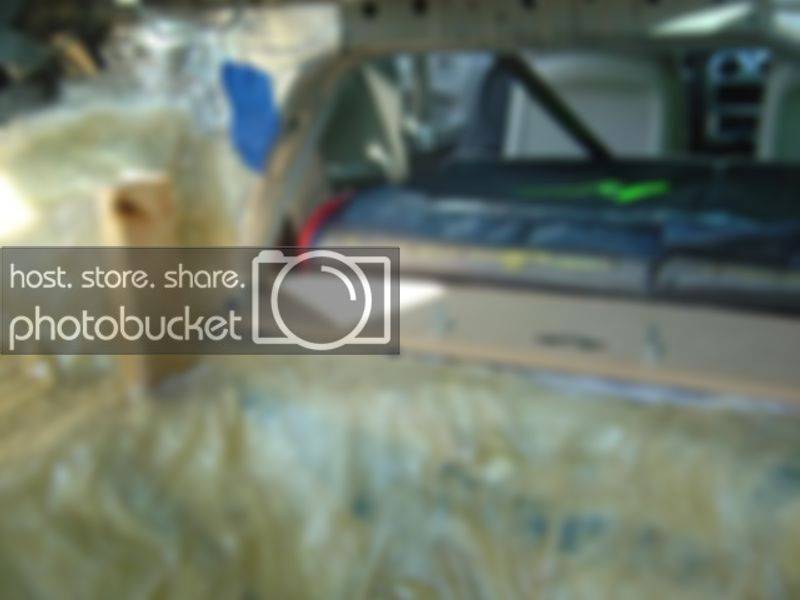

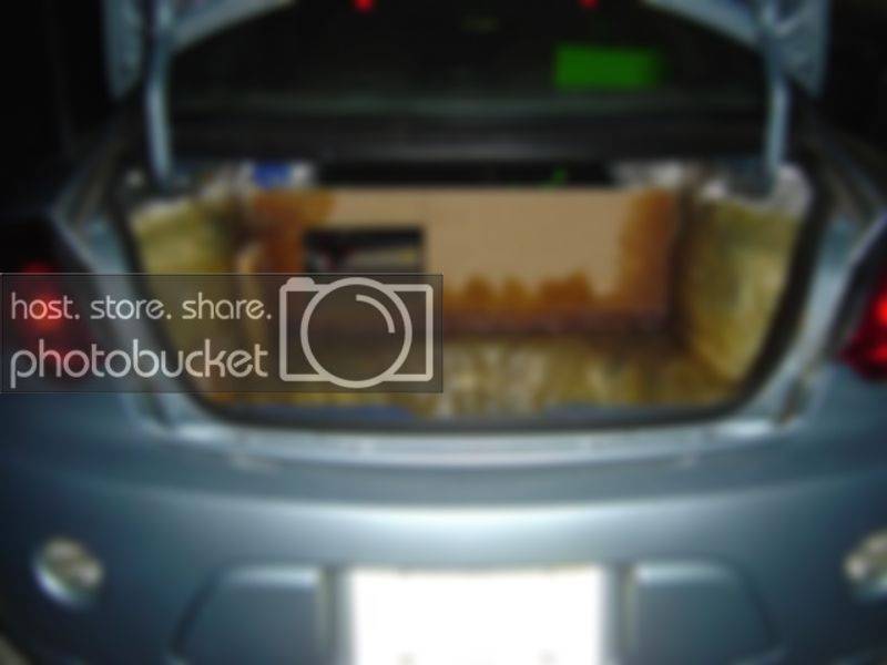

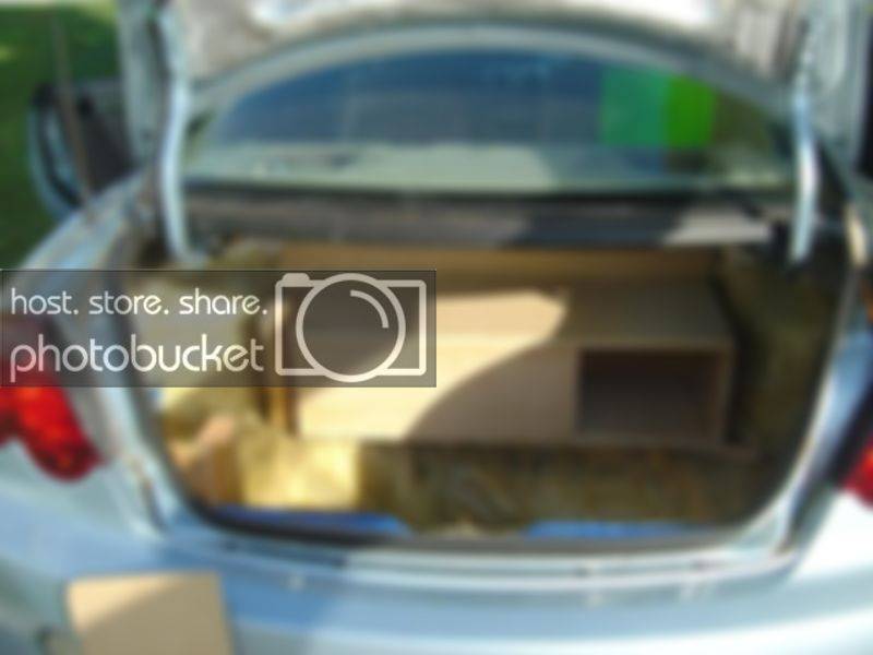

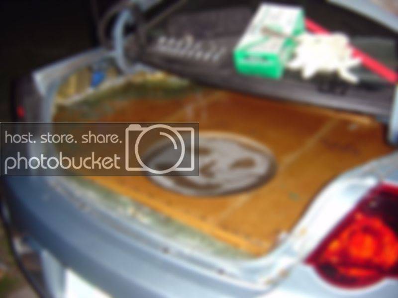

I will be tearing out the old baffle, and the front.
Making some kind of base, battery rack, and amp rack in the trunk.
Clamshell will go behind the seats, then I will seal the trunk off, stuff it with polyfill.
I bought E8's (sundown)
