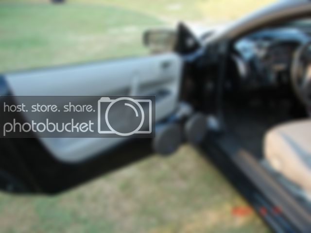

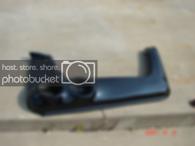

im sure it will jiggle your nuts and sound great. doors are comming along better than i thought but im very scared about the joint between where you taped off the inner area and where the glass meets it.
you should have decoupled the center part there from the rest of the panel. there are little plastic melt rivets on the back, and you could easily have popped those off (a nice big drill bit does the job well by drilling out the plastic melt part) and they come apart. then when you are done glassing, you get some plastic and set it on fire (after scraping up the area nice and well) and then you melt the rivet area - and then stick the two melting plastic pieces together and trim with a dremel and it welds the ABS together like the original rivet, but a little uglier //content.invisioncic.com/y282845/emoticons/smile.gif.1ebc41e1811405b213edfc4622c41e27.gif
so good luck with that part //content.invisioncic.com/y282845/emoticons/crap.gif.7f4dd41e3e9b23fbd170a1ee6f65cecc.gif

I was kinda worried about that too, but I wasn't sure how I was going to put them back together, so maybe I will take them off and try that.
thanks for the info, that's a good idea, 1 already started coming apart anyway.
