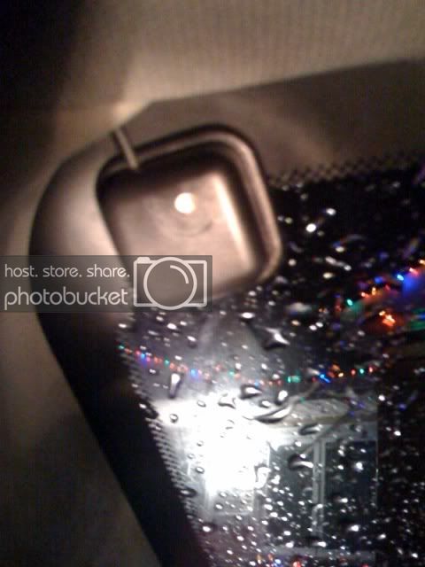

that makes sense, the shops gonna hate me, everytime i get something installed at any shop i always have problems. it worked fine yesterday, i had to take it back cause my keys wouldnt program to the xk532 i think they just didnt know how to use it, and then they put a different one in now the alarm doesnt work. is this what im going to be adjustiong?
no that's your "knock" sensor what that is is for like if someone wanted to get your attenion while u was away but in range and you have that turned it it'll inform you by ur 2 way ***** mitter.
but you have to activate it via ur tansmitter.
no that's your "knock" sensor what that is is for like if someone wanted to get your attenion while u was away but in range and you have that turned it it'll inform you by ur 2 way ***** mitter.but you have to activate it via ur tansmitter.
