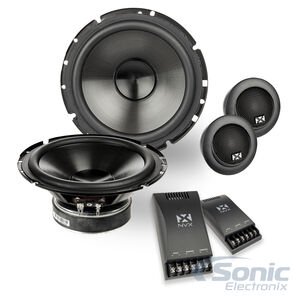

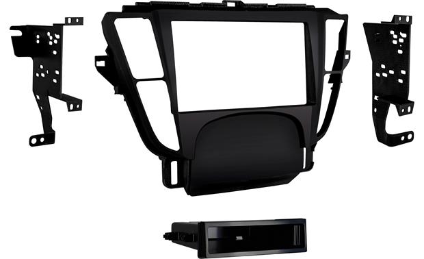

deck recommendation:
comps set recommendation:

Talking speakers: What do you think about Audiofrog GS62's? They are 75w RMS @ 4 ohms so my Sony amp would fit well there at 80w x 2 @ 4 ohms. Would these give me good crisp vocals with great clarity and high volumes, acceptable mid range bass and not too harsh on the highs?

OK guys, been doing more planning and researching and this is what I plan on doing:
Replace HU with Pioneer MVH-1400NEX, replace front door speakers with Audiofrog GS62's and power with my Sony Xplod amp for now (80wx2 RMS), use my ported box for this vehicle, subs I am undecided, amp for subs will probably be Skar SKV2-1500.1D, wiring will be 1/0 from batter to trunk- distribution block with 8ga going to speaker amp and 4 ga going to Skar amp, sound deaden the doors and probably the trunk, run all 1/0 big 3 wiring but keep stock 130amp alternator.
