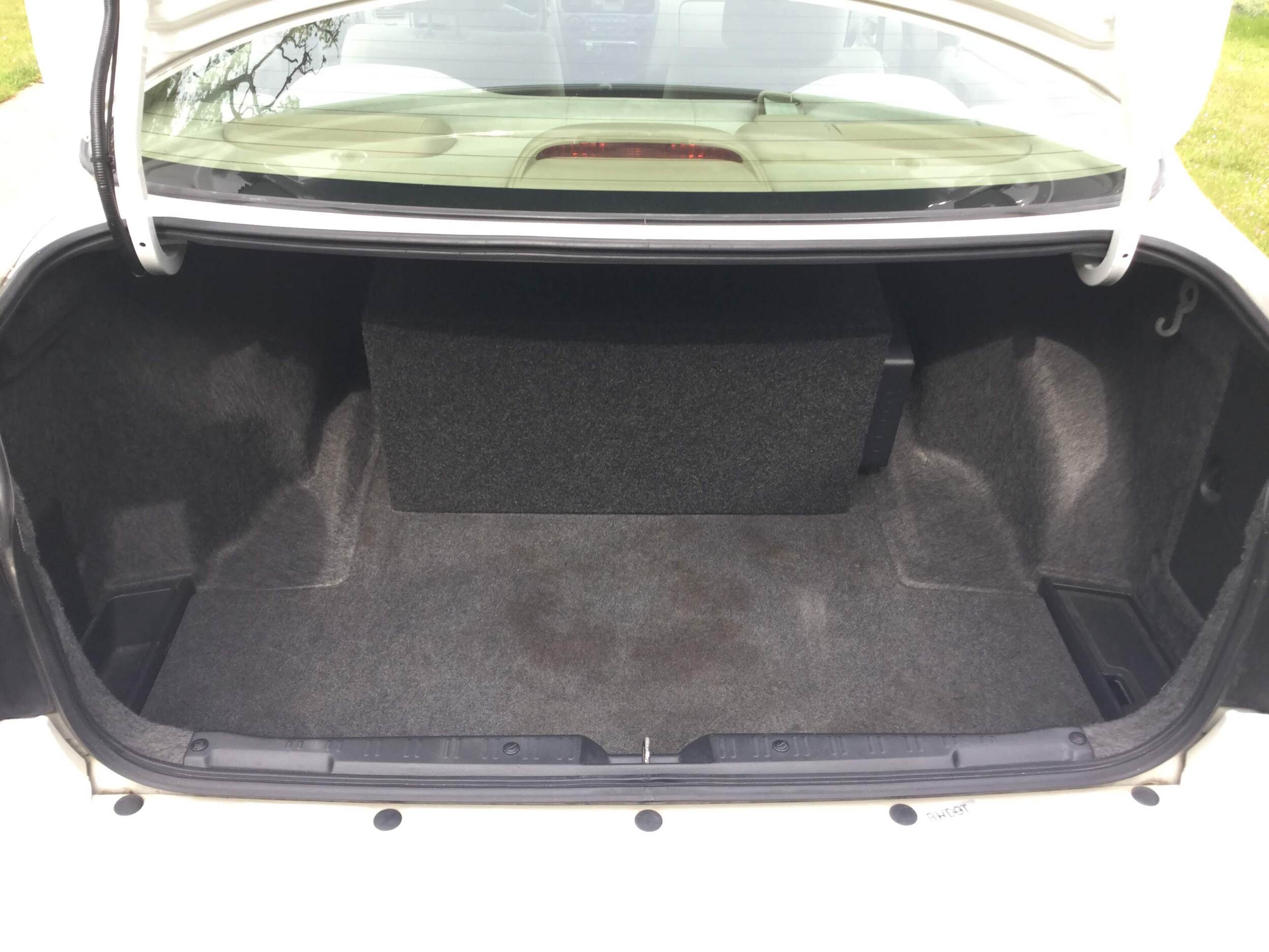

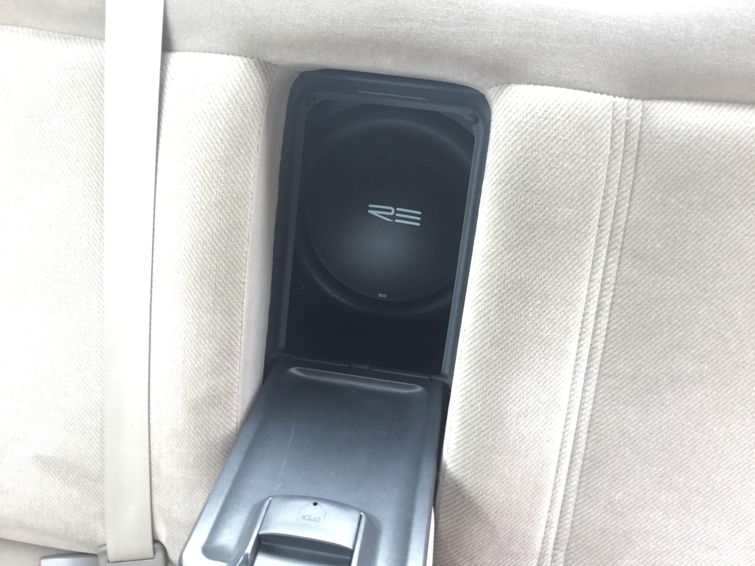

fwiw, heres my setup in my Accord sedan. box is 1.31 cubes. subs a 12" RE SE. i took out the rear dash speakers to let the bass vent into the cabin. i dont keep the armrest/port thing open. dont need to. the box is held in place by 4 L brackets. and i can still get to the spare tire
21655
21656
