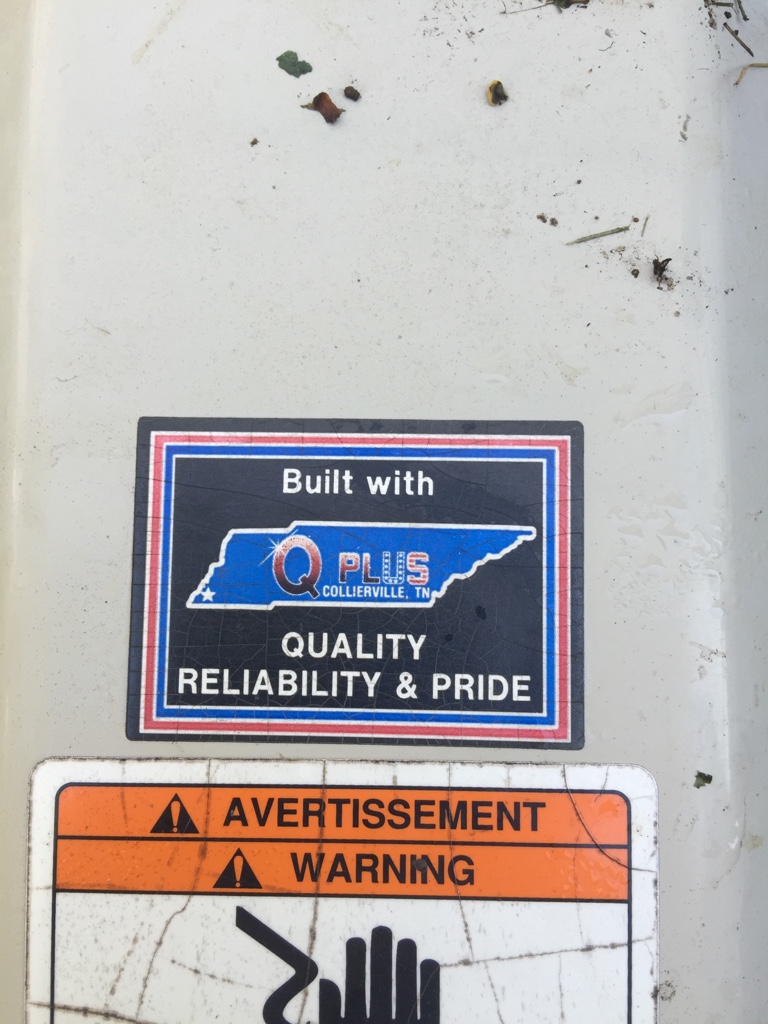

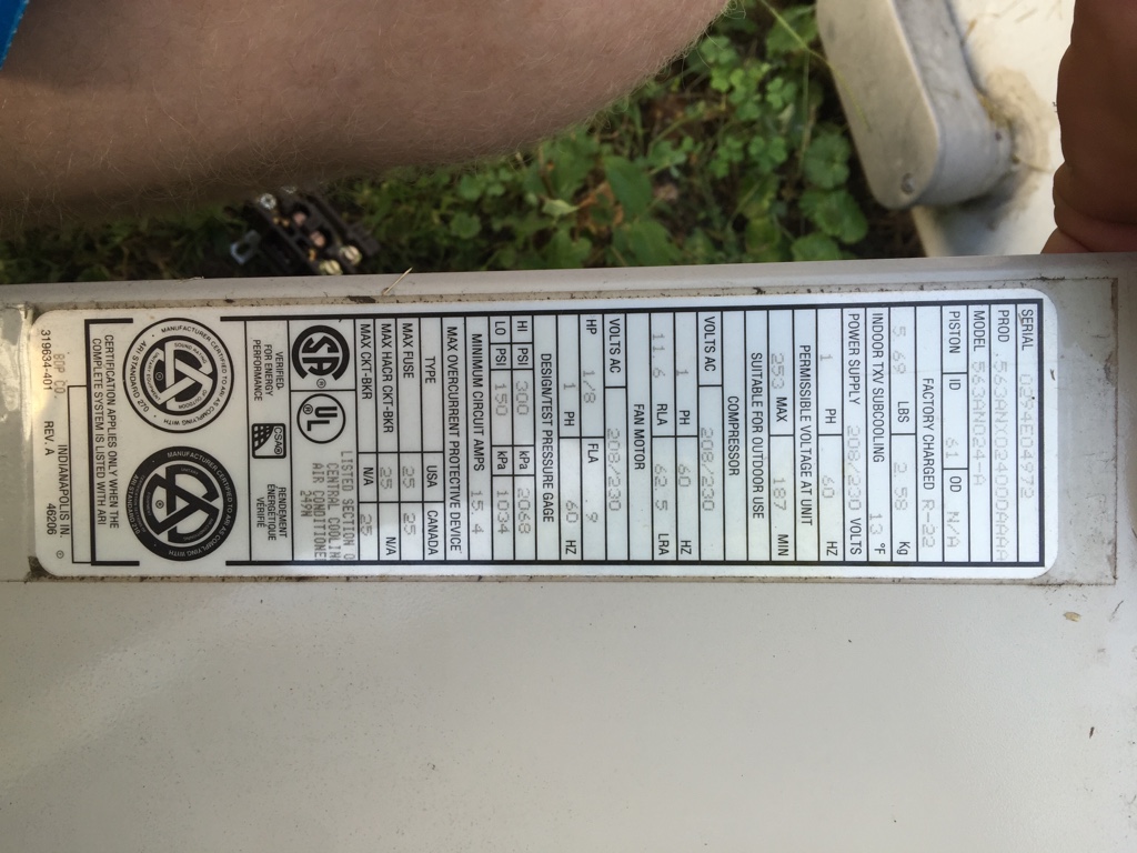

It's a carrier/Bryant from '94, you can pm me I can help you better from the phone.
Sent from my SM-N900V using Tapatalk
sh it! you want a job in florida? My techs would have called me and asked hey boss, what kind of unit is this and how old is it? Ive been doing this for 15 years and still cant read a **** model and serial number" Youve passed the first step
