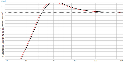

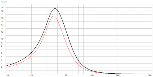

After messing around this is what I got (Red) over recommended (Black). Should I try and move the dB bump to the left or right?
