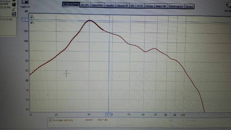

This is my Icon 12" in roughly 2 cuft ported at 30hz.

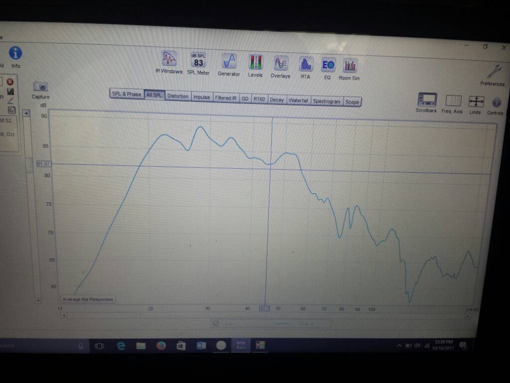

This is my Icon 12" in a IB config.
