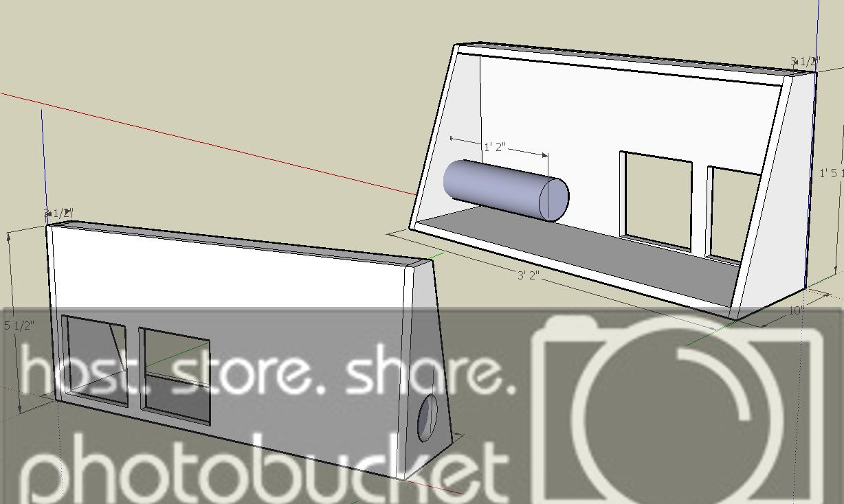

Thanks Beaver I appreciate it! It will fit it's the cargo area of a Jeep, no problems there. Quick question, Does the placement of the subs to the port chamber matter? Could I have the subs on either side of the box and the port coming out one side or if the sub is on the right should the subs be on the right as well?
I would stuff the subs all the way to one side of the enclosure and fire the port out the opposite side. If they're going to be rear firing I'd probably hug the drivers side with the subs and vent out the passengers side, FWIW.
Alright, So how does this look?
To the best of my knowledge the only way you'll get a ssf is to buy an amp with that feature... I could be wrong, though.
Otherwise, depending on the rest of your set-up, you could set the x-over on the head unit at 30/24db HP and then use the amps x-over for LP duty... Like I said, it depends on the capabilities of the rest of your gear.
Depending on the type of music you listen to, you may not even need a ssf...
hey pokefan have you come right with your enclosure details? me personally i would have done a few things different but in this game its all about what you want. to cut the angles you must use a table saw, a circular saw or a jig saw. otherwise you can ask the guys you buy the timber from to cut it to size for you with the angles. hope that answers your question
Yea, it's pretty much set. This one was basically tuned by beaver but I'm always up for suggestions.
I've got access to a table saw but couldn't figure out how to cut those angles with it. I mean the one that runs the length of the boards on the top and bottom not the long angles of the side pieces.
