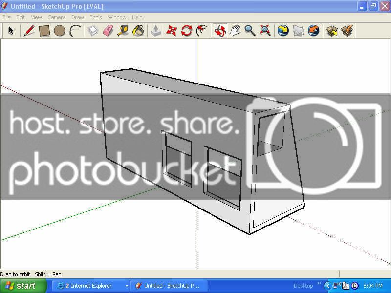

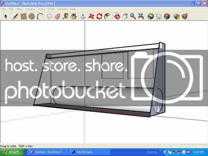

Here goes the model...
I don't think the port would work side firing would it? It will be right up against a wall. And what size is that port? Looks to be around 7" is that big or not?
Beaver, I'm glad you brought that up. I almost forgot the subs need to be mounted on the bottom half of the box. they have a 4.75 mounting depth so they have to be under that part of the slant.
with your layout, side fire port will not work, as you will have no space for the port to breath
a single two inch port is gonna whistle like crazy. plan on stepping up to a 4" port, or dual 2"ers.
Also, the measurements you just listed make the enclosure 1.6cft. GROSS. once you account for driver and port displacement you're looking at much less... which will require longer ports.

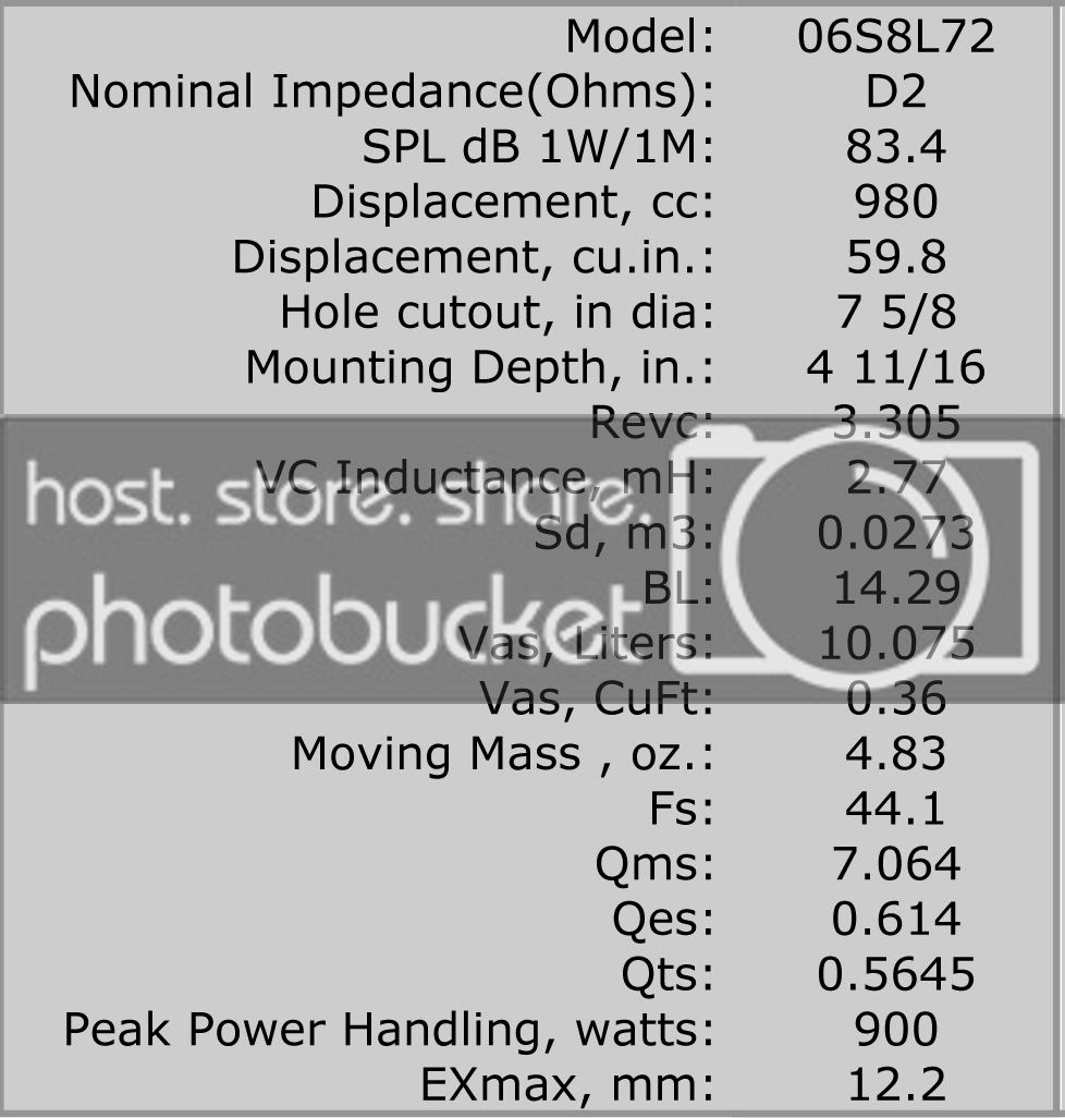

If you can supply me all of the ts parameters I'll see if I can model something up for you.
