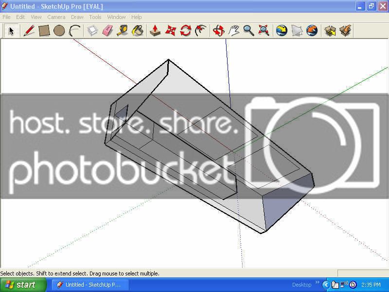

Sorry, I went to lunch and missed a few post. For the most part that's what I'm looking for but it's a pretty tight squeeze to get the box in and the port would be right up against the side wall. I think I'm going to have to have it come out the front. I was thinking round ports as well for simplicity sake.
