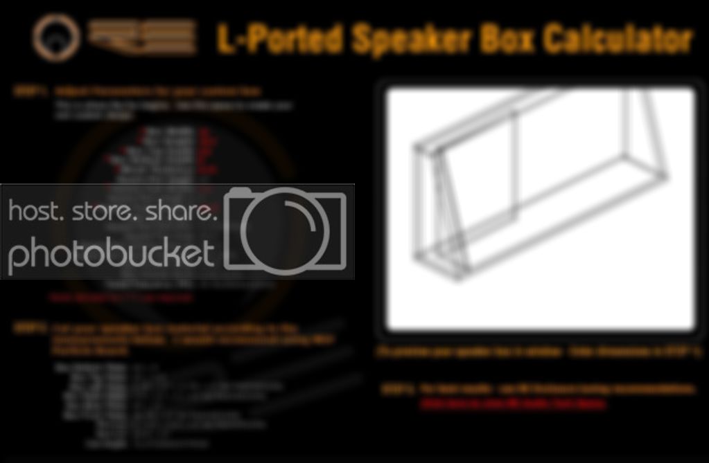

Can someone help me out with this? I need to know what the ports should be for this box.
This is what I've come up with I think it's right.
Wedge box
2 8" L7's
42x16
top depth=3.5 bottom=9
Tuned to 30hz
Box should be 1.53^3 @30hz
I don't know what other info you need if any let me know.
.....well i dont' think this is accurate but i'm showing the port to be 1" wide and about 24.5" long........4.5 deep, and 20" long.....being that the port will be L shaped

Jeremy thanks, but you kinda lost me here. So if the ports are to be 24.5" long my only option would be the front face of the box facing the rear right? So the opening would be 1" tall and 24.5 long across the bottom?
The 4.5 deep and 20 long is where you lost me though. Is that 4.5 back and then 20 up? If that's the case would the back being at a slant affect that port size?
Sorry simple math could've figured that I guess. The total port should be 24.5" with a 1" opening right? So do the opening dimensions matter as long as it's 1" opening?

The total port length is 24.5 ( 4.5" back & 20" to the right - port opening will be on the left front side ).
... for this is work... It has to be a 1" opening.
Yes, it's essentially a truck box. I'm trying to get away with taking up as little room as possible in my rear cargo area. With those top and bottom dimensions it will sit flush with the top of my seats and basically just go straight down.
I don't know anything about the tuning. I found a calculator online that you put in all the sub info and it kicked out the tuning specs. I'm up for suggestions and if I need to look at this again I'm all for it. Any help at this point is appreciated.
Well, I played around a bit and came up with a 40hz before I saw your post. Should I shoot for 50 instead? 45?
Here's what I've got but the only issue is this box will be facing the other direction. How would I go about making the port against the slant? Subs will be mounted to the flat face and the angle will be against the seat. Does this create other problems?
