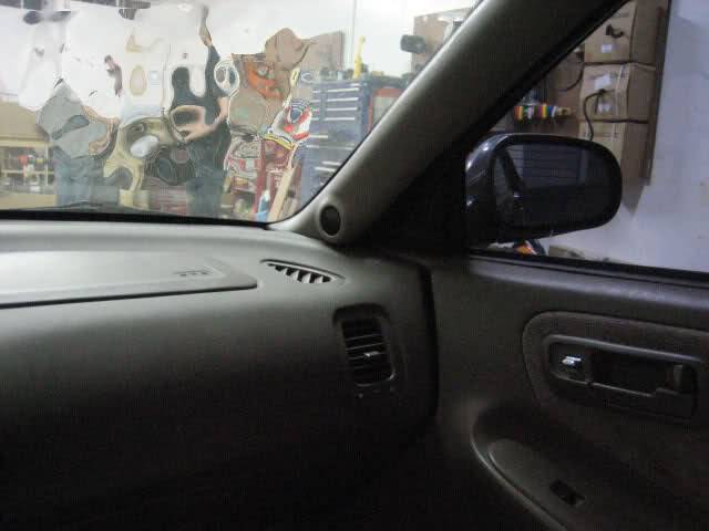

hey i have an integra and am thinking about fiberglassing my tweeters onto the a-pillar triangle(the a-pillar triangle is that black triangle piece you see next to the tweeter in the following picture) of my car.. here is a picture of some guy who had it done
custom on the A-Pillar itself..
qqcr52.jpgit
this shop custom-made the a-pillar section of the car so that the tweeters point inward toward the windshield and i always thought it was best to aim the tweeters between the front seats' head rests.. but i guess not? on the website it says
Remember folks, if your tweeters are soft-domes, you must have them pointed AT you, otherwise, you will lose all the details. If the tweeters are hard-domes, have them fire straight across to get good stage while maintaining the details. But Aaron @ IR knows that already
is this true?? and what are considered hard-dome? aluminum and titanium? i have infinity perfect 6.1 components and the tweeter is a titanium-dome i believe.. i have them pointed between the headrests.. should i change them to point toward the glass more? i plan to move them to the a-pillar when i learn to fiberglas.. until then im going to practice
it's all about trial and error. imaging in one car may not be the same in another vehicle. you'll just have to take some double-sided tape or adhesive and play around with angles and possibly switching phase/time alignment. if you have them aimed at the glass, then you'll get "reflection" off the windshield and may screw up imaging.
and btw, you're wanting to 'glass the sail panels. //content.invisioncic.com/y282845/emoticons/wink.gif.608e3ea05f1a9f98611af0861652f8fb.gif
