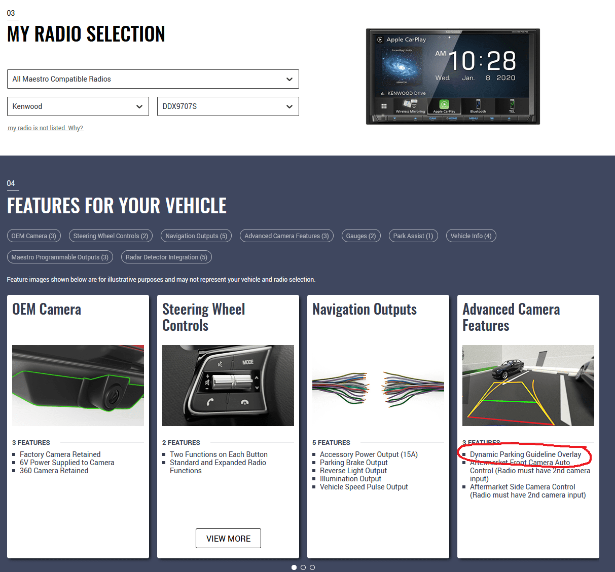

Yes, my car has a backup camera, but it's terrible and has been terrible. I was thinking of upgrading that AND get a car radio but if I could do both. It's not only gotten cloudy (despite cleaning the lens) but cuts in and out due to a loose connection I guess. I drive my Mom's new vehicle every once in awhile and her backup camera is so clear any time of day or night and the guide lines will turn and adjust with the wheels. Mine are straight with the green, yellow and red sections. I would like something better here.
I didn't even know you could add dynamic parking lines until I looked it up. Looks like it's possible with your car too.
look up here: https://www.idatalinkmaestro.com/en/products/maestro-rr2
keep in mind the maestro rr2 is 210 bucks and you'll need a harness to connect it to your car, and that's on top of a headunit that supports this which will be at least another 500. So it'll be 750$ which may or may not be worth it.
