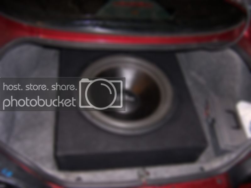

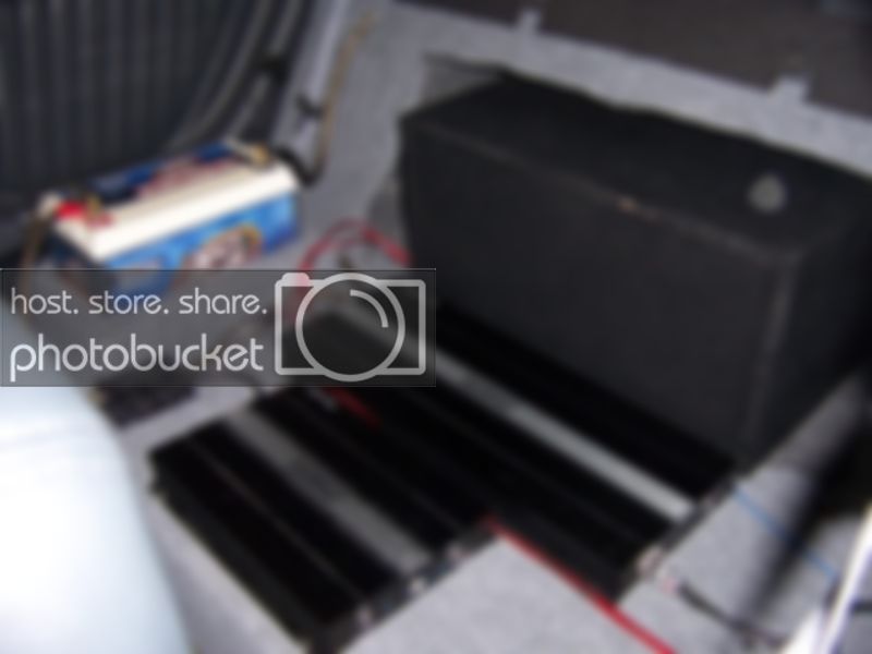

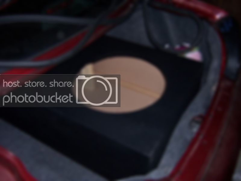

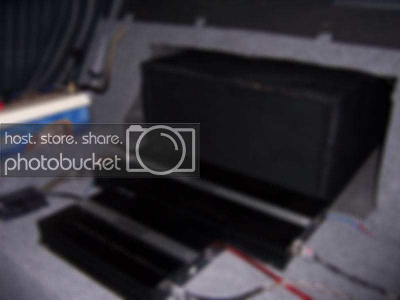

Well we started the build earlier today around 12:30 or so. He had most of the wiring all in, batteries, deadener and his amp rack setup in the back seat...which looks tight as hell.

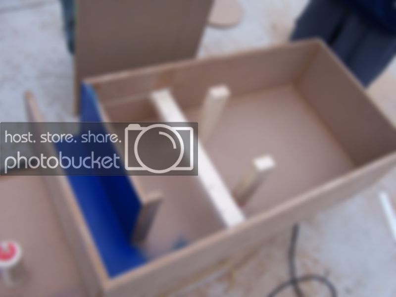

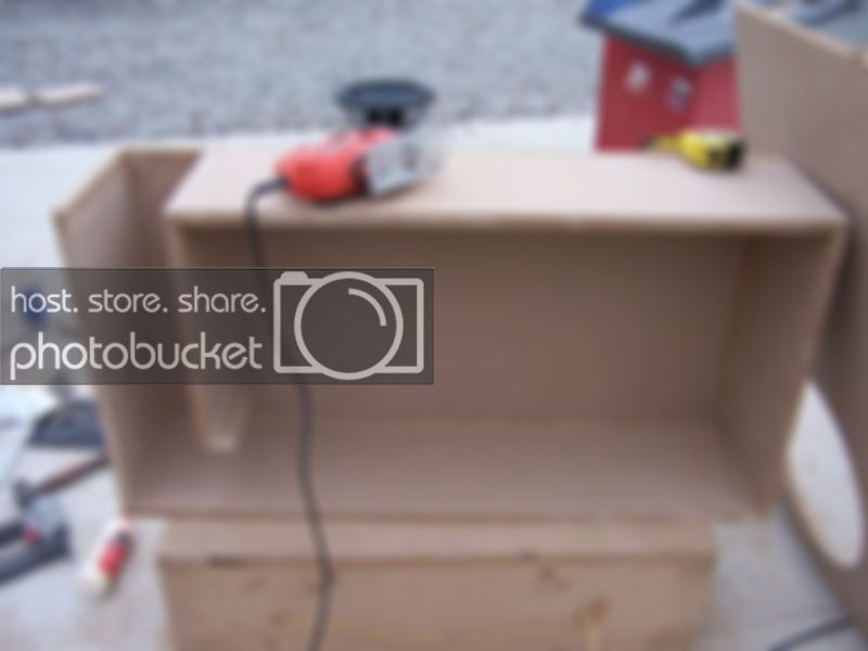

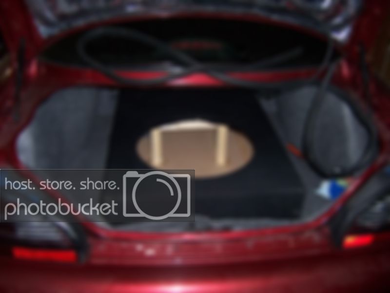

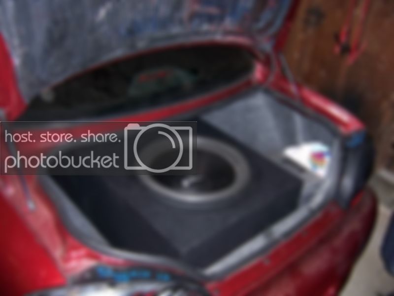

Started out with the box. Couldnt go with his original idea to the size restrictions, which kind of stinks but we managed. The box is a little small but it was the biggest that could possibly fit sliding into the trunk without doing a complete build in.
Before displacement its just under 6 cube, about 5.8. Its tuned to 32hz and after all displacement sits at just under 5 cube. I was hoping to get 5 out of it but there was just no way it could be even a 1/4in bigger in any direction //content.invisioncic.com/y282845/emoticons/laugh.gif.48439b2acf2cfca21620f01e7f77d1e4.gif
After running the dims again its ~4.9cube.
Should eat up some serious power in that box though //content.invisioncic.com/y282845/emoticons/naughty.gif.94359f346c0f1259df8038d60b41863e.gif

Also, the good part is if you ever do have to take it out, just pull the box into the car again, pop the sub out, and then slide the box out your door opening. **** that latch shit lol.
We'll get it goin though and do some tweakin, see how you like it. And if its not up to par we can consider another box down the road. Use some aeros, maybe external or something to get the most out of the space.
Might be able to make something around the same size, but wider, and then just pull your drivers seat and stuff it through the door way.

nice man. im guessing that box is less than 14 inchs tall? did you guys just slide it between the opening once the rear seat was out?what are the dimensions if ya don't mind.

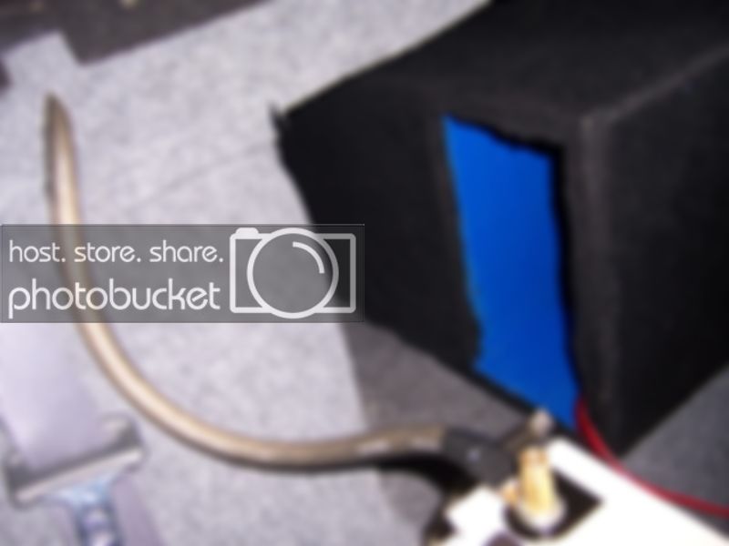

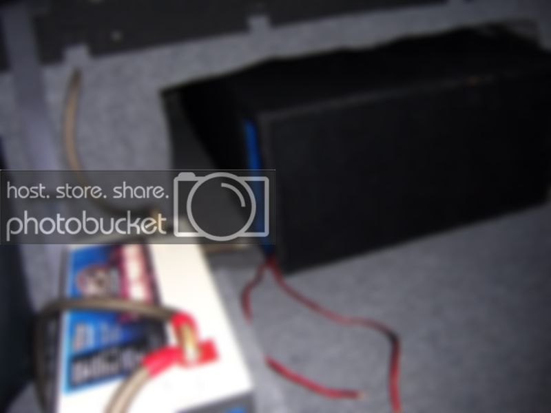

Havent got the chance to power it up yet though. Thinkin theres an RCA issue or something. It was gettin late and he had to head back so we will finish it up tuesday and get the front stage in.
Yeah its 12 tall, 23.5 wide, 46 deep. We put it in through the trunk opening though. Had to pull the top part of the bumper off to get to the latch bolts to move it down so it would fit.
Just to find out it will fit out the door //content.invisioncic.com/y282845/emoticons/laugh.gif.48439b2acf2cfca21620f01e7f77d1e4.gif

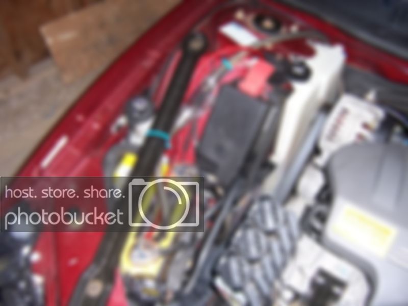

lol ya that sucks. not bad though gave me a new idea for a box. id love to be able to stuff 2 15s ported though. and is he running stock alt? im wondering if his voltage is going to be alright.
