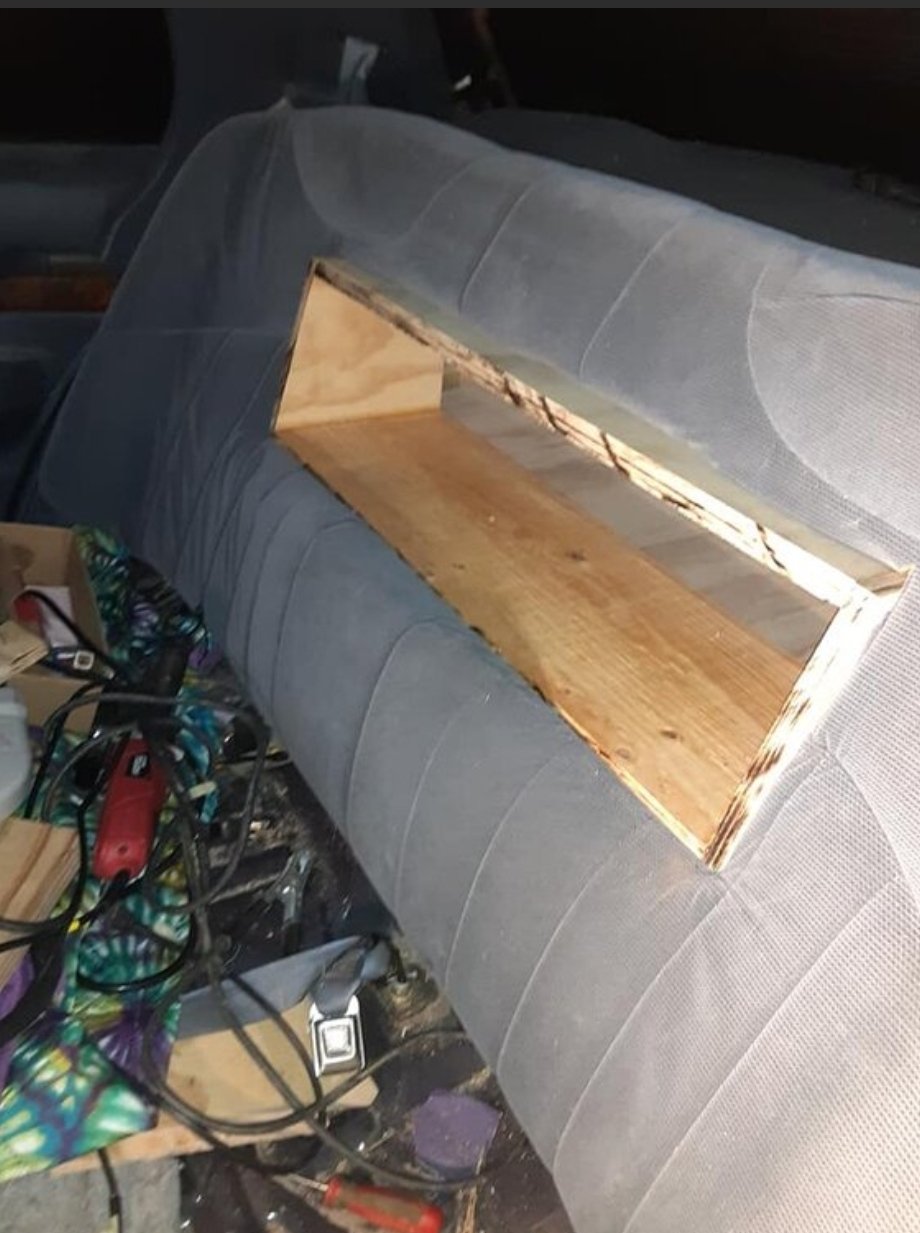

In my 2001 BMW convertible we just folded down the center arm rest and cut the hole out with a sawzall. I ran a single XFL12 in the trunk in a pre-fab box for a Kicker L7 12" (new baffle piece). We aimed the sub right at the hole in the armrest. It got down pretty good. I only had an 1,100 watt lightning audio amp on the sub. If the OP wants any kind of "legitimate" bass, then, he will have to use the trunk.

3. break down and put something more efficeint in the trunk and cut a hole in the wall between seat and cabin as bobby mentioned.
Problem solved. A 4th order in the trunk just like this guy. 🤣
