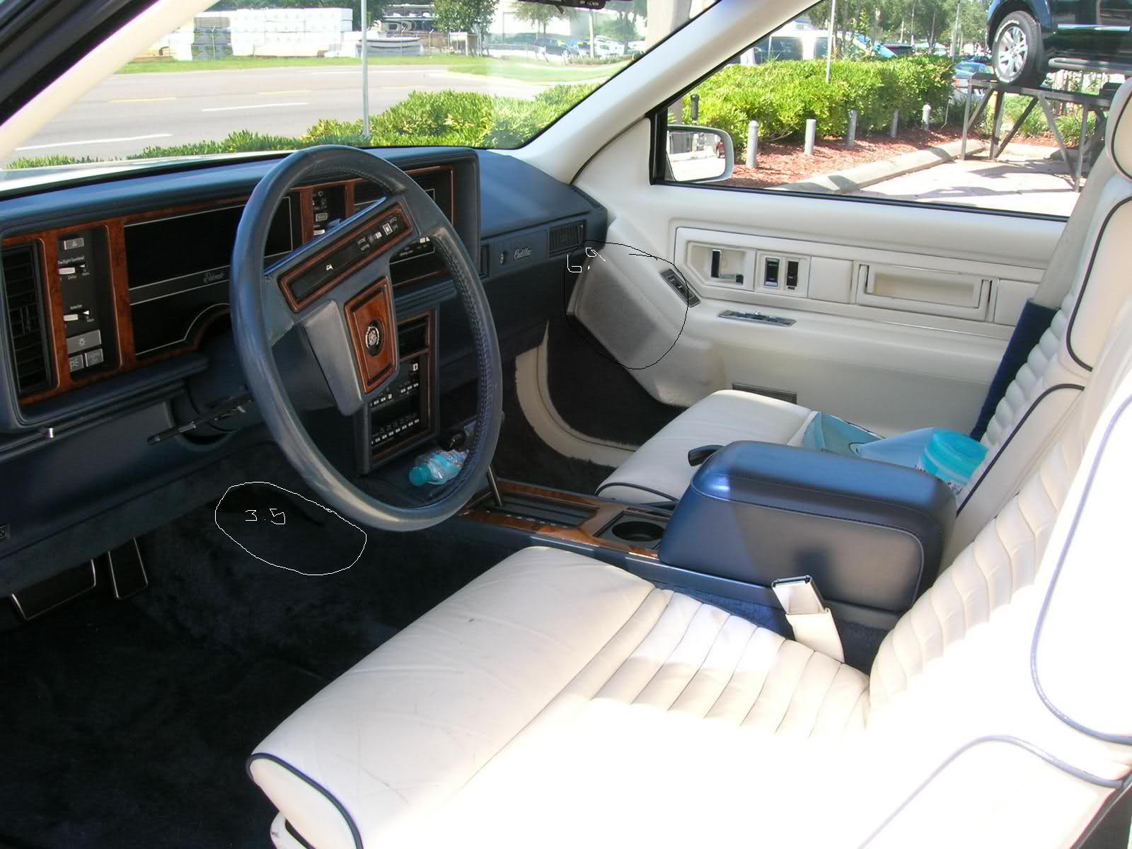

so by putting them in an enclosure will i be killing sum sound and clarity out of them? but i will be helping them reduce dissortion from the sub...so its a loose loose isint it? well there really arent that low heres a pic
Car looks clean as hell. I dont think it'll affect your clarity. The only thing it would possibly affect is how low they extend in the midbass region (like being able to play them down low into the sub bass region) , but being that they are rear speakers, and u have subs for your lows, it won't matter.
