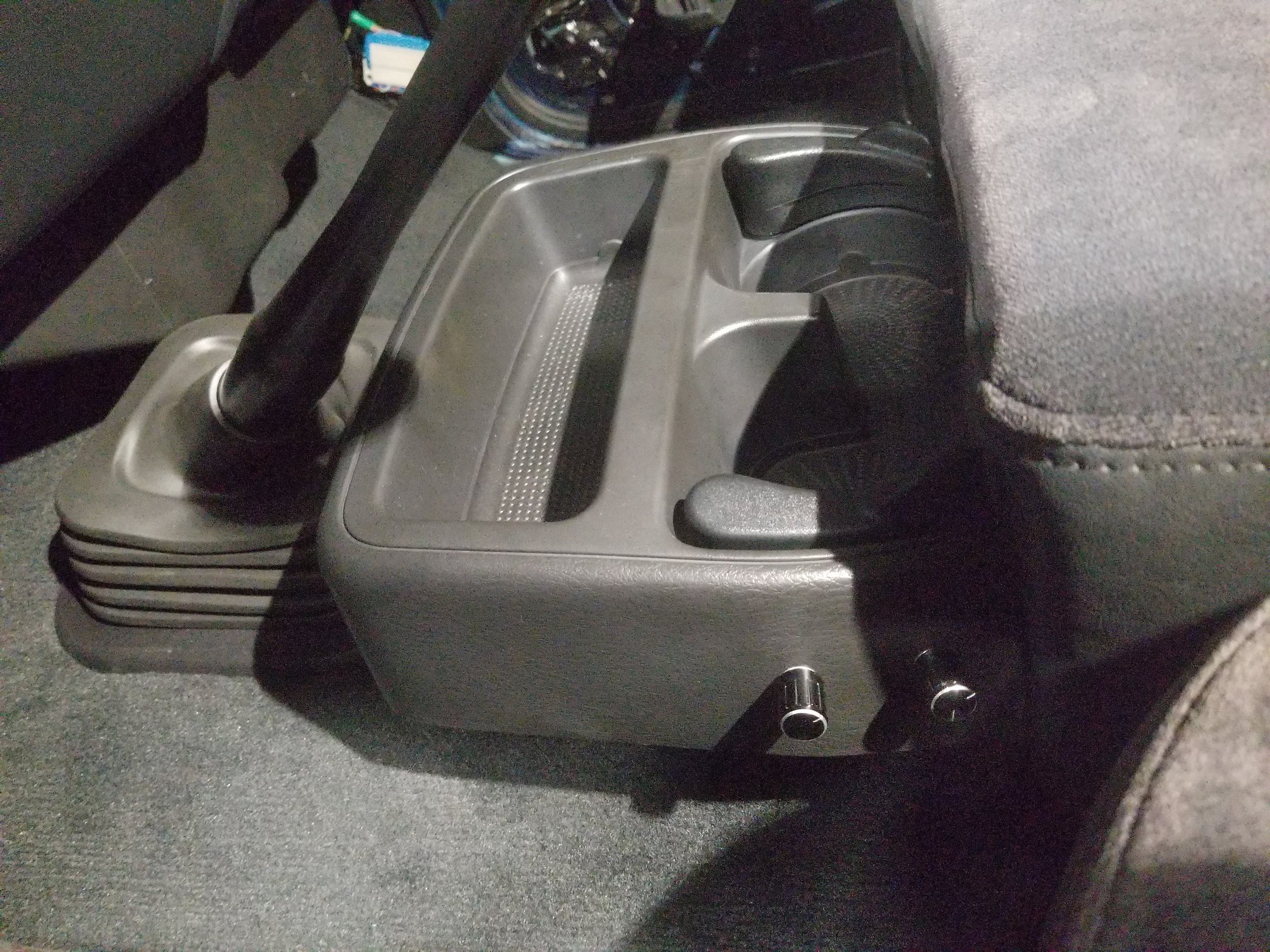

Here is what I did:
Amazon product ASIN B003FPD3ISThese control signal voltage.
I'm using two of those. Both are inline on the RCAs, head unit to this and then out to amps. One has my subwoofer amp, and the other is to the components. I can turn the head unit on as loud as I want, and then independently control the subwoofer and the components. I really enjoy this option. I find it best to turn the components to about 80% and the subs on full. I can turn the components off and have subs full if I want, or vice versa. I mounted them so my leg hides them while driving, but easily accessible, and discreet.
So I'm sending full voltage/max volume from the head unit, then dialing it down as much as I want to either one.
