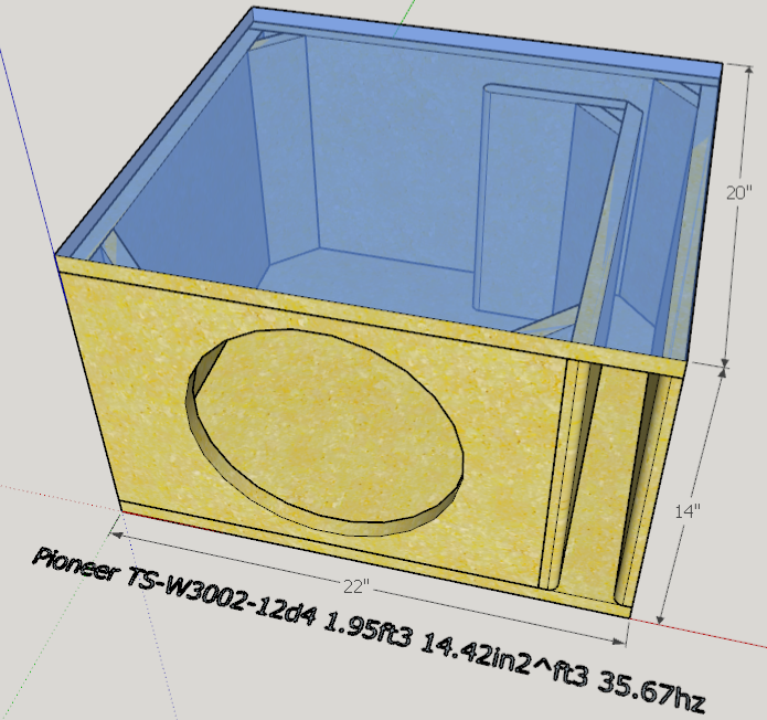

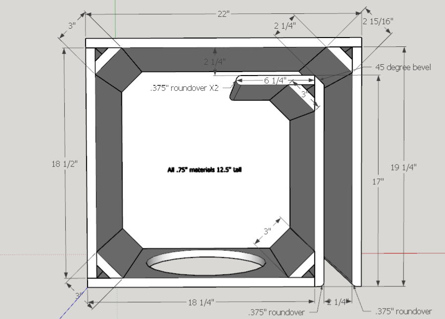

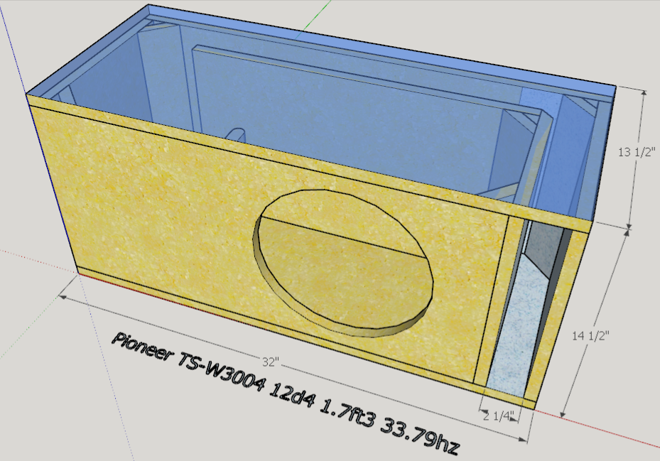

What is the recommended ported box tuned to in the manual, 1.5 cf w/ 3”x 6” port? Seems small to me
Which prefab do you have? What’s the airspace after sub and port displacements?
well i did have 900 rms on mine box was 1.65 cfad tuned about 36hz.. i think the say 33hz  but after sub 35-36 is closer, if running less power like 500rms get the next one like it up it's 2cf total be 1.90 or so after sub but it'd doesn't need more airspace than other box if u have 750 rms or more https://www.ebay.com/itm/12-SINGLE-1-75-Cu-Ft-PORTED-L-VENTED-3-4-MDF-BLACK-SUBWOOFER-SUB-ENCLOSURE-BOX/282600080758?hash=item41cc470576:g:Vm8AAOSwpRRWn1jz:sc:FedExHomeDelivery!28326!US!-1
I may just copy the dimensions from that 1.75 cf box and build my own. I listen to metal most of the time so don't need it tuned low.
Why copy a prefab?.. this was for a RF P500X2 (700 watts). I can resend the plans if you'd like... just pm me an email.
