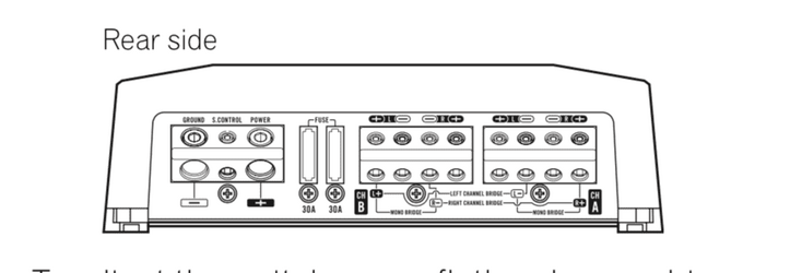

I have a Pioneer GM-D8604 1200w Amp and would like to ask if I can set it up as a 5 channel even though its only a 4 channel amp ?
Ive added a photo of the rear of the amp and could anyone kindly tell me how to wire this as a 4 speaker plus 1 sub setup ? The speakers I have are 4 x 75w RMS plus 1 x 400w RMS Sub

Nope. Only does 4/3/2 channel. You need a 5 channel amp like the 9605 or ditch the rears and do fronts to channel A and sub bridged to channel B.
