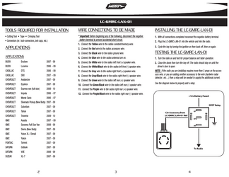

Online, it appears that documentation from Metra requires a Relay be installed over 3amps.  This is not included with what you get in the package.  The Kenwood is fused at 10A as maximum consumption, so I am assuming I need more power.  I am going to post a couple photos... I'm not 100% sure I've got the relay wired up properly, if it needs to go to fuse panel, etc.  I am trying to follow the instructions that I found online.  First photo is of my initial wiring of the harness then instructions... then the relay instructions and my attempt at the relay.  I apologize, I know the wire colours are not correct on the relay, but it came prewired in those locations and colours.
From the relay:
black wire is on 86 and going to both black ground wires (all together)
green wire is on 85, going to the red wire on the LC-GMRC-01
red wire is on 87 going to yellow wires for the LC-GMRC-01 and the Kenwood Harness
blue wire is on 30 going to the red wire on the Kenwood Harness
yellow wire is on 87a and not connected.
I did buy fuse taps and wire to run this to a 10A fuse in my panel, but according to the diagram I'm not sure where this goes.  I could see how maybe the wire at 87 should run to my fuse block and maybe the wire at 30 should go to both red wires all connected.... as you can see, I'm all confused....  All help is appreciated.  I've just twisted wires together on the relay, but will solder and shrink tube them after I get this all worked out.
Thanks for the pics.  Good detail so far and glad to see you are taking the time to do this correctly (solder, shrink, tidy, etc).
Relay wiring looks correct.  You can tie pin 87 to the constant wires at the harness (yellow) and that should be fine.  you'll never pull 10A anyway and most wires don't pull more than 3A on the accessory (red) wire, they source current on the yellow wire.
I prefer to ground aftermarket head units to the chassis directly, but the factory ground wires should be ok.
A DMM will help here, so you can measure voltage and verify you have 12V at both yellow and red wires (battery and ignition) on the Kenwood harness.

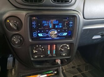

Tried with the relay I had wired up, but no luck... took it all apart and started with my DMM.  Power issue... Soon as I found the 12V, I adjusted the harness and it powered right up and works perfectly.
