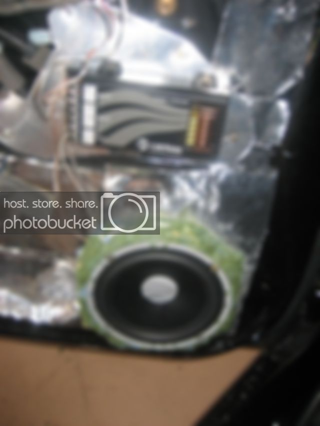

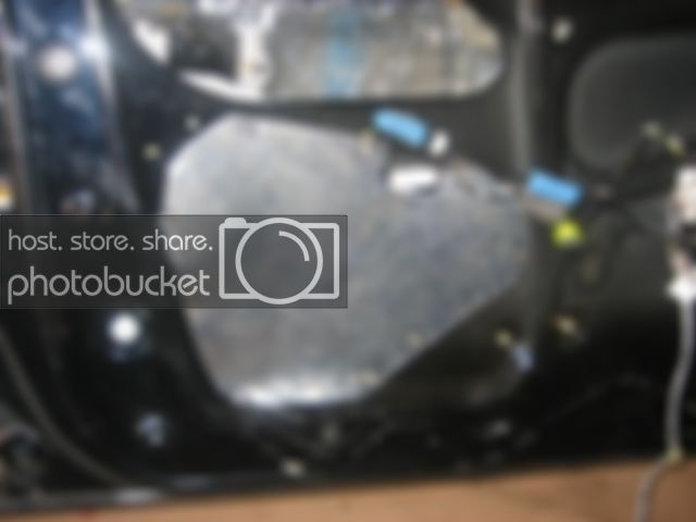

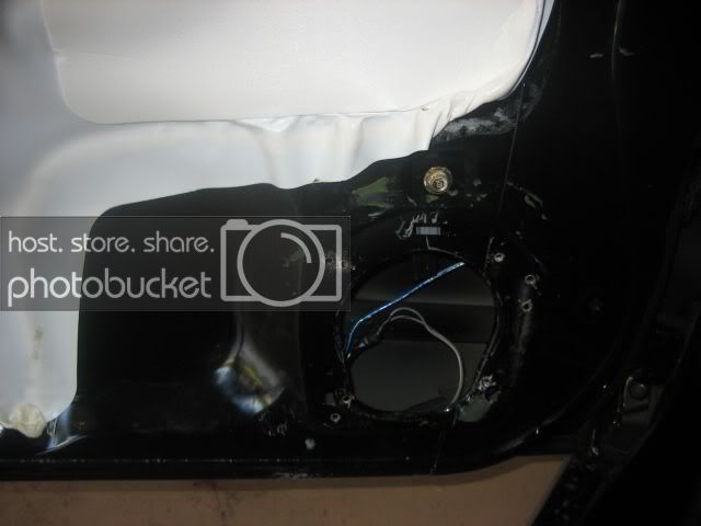

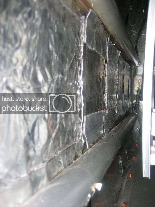

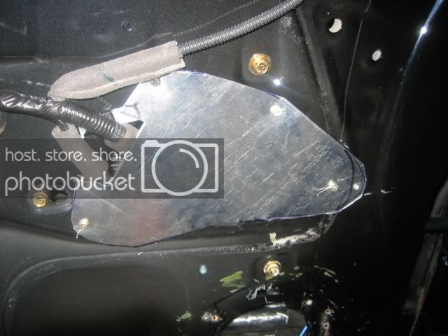

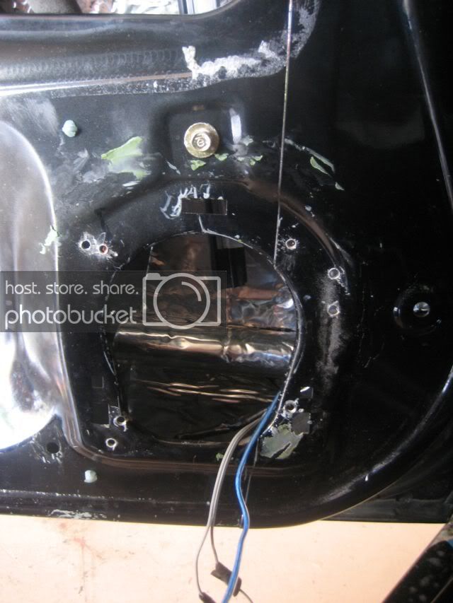

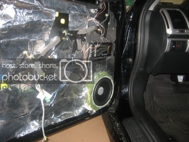

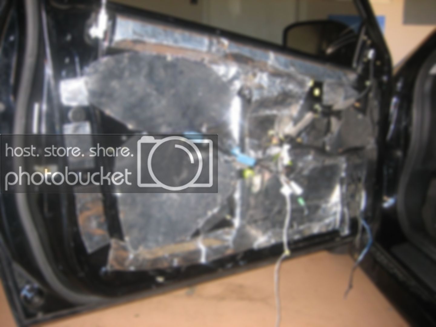

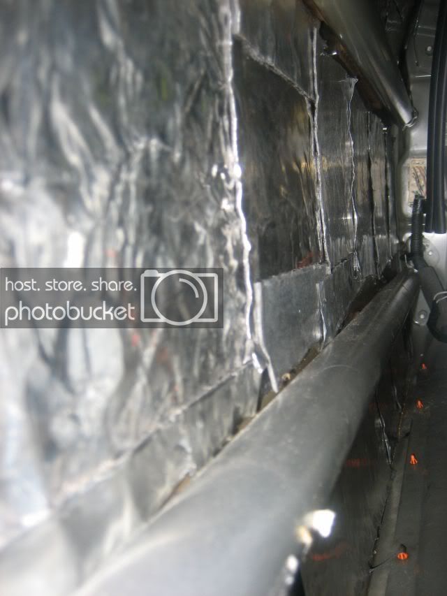

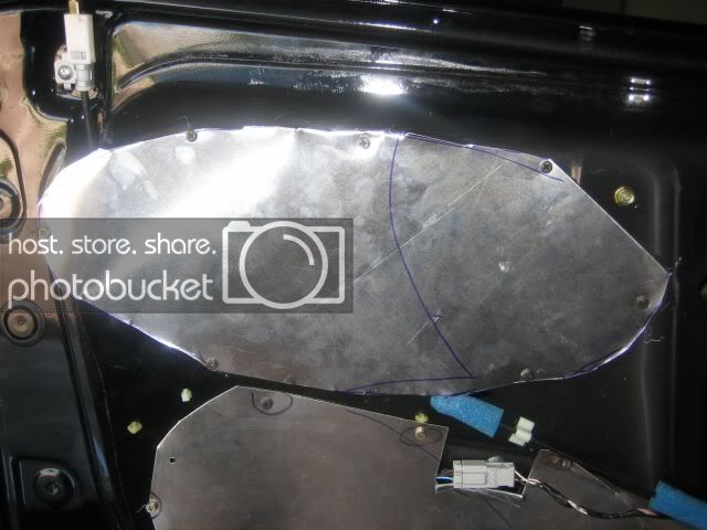

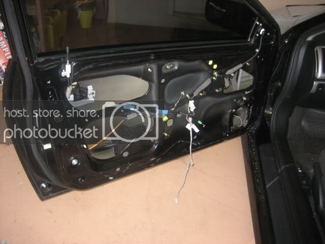

Well, after getting my 2x door kits in from second skin, I decided to start on my first door. I have 12 Sq.Ft of Damp. Pro per door. I could have used just a bit more, but it is fine since I dampened them inside and out, and sealed them. I am currently waiting on a jl 300/4 delivery, in the mean time I have run the wire to the trunk where the amp will be and I have ran the wire through both door jams PITA (you can see the blue wiring just hanging out of one of the holes in the door duck taped). Right now I have the rainbow slc 265 hooked up (driver side only) to just the stock wiring through the crossover, as soon as the amp comes I'll be able to just switch a couple wires.

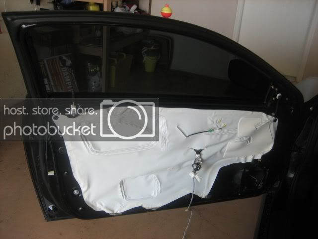

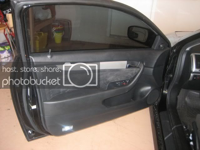

Well, for the project, I applied the second skin to the inside of the door, from there I cut the proper size sheet metal, sealed the openings with screws and silicone. Then applied what damp. I had left for the door. From there I installed the mdf baffle I made. (installed with butterfly nuts. I then mounted the speaker (carefully) and sealed it with non-hardening clay, anyhow the speaker sounds good, of course it will sound 10x better with the amp. I just couldn't stand to see my rainbows sitting in my closet for 3 weeks, along with my door kits I just got in. So when the amp arrives I'll hook it up. I plan to do the other side in a few days. Btw the second skin is awesome. Here's a lot of pics:)
I should probably deaden the sheet metal, the thing is I'm out of dampener for this door. I mean I dont know if it would make a huge enough difference for me to order some more, and apply it over the sheet metal?
Absolutely! Think about it...it's thinner than the metal on the door and will resonate like crazy. If you are in a pinch for some deadener, just get a roll of gutter repair tape (peal n seal) from Home Depot. A good $16 fix. You will need a few layers though.
