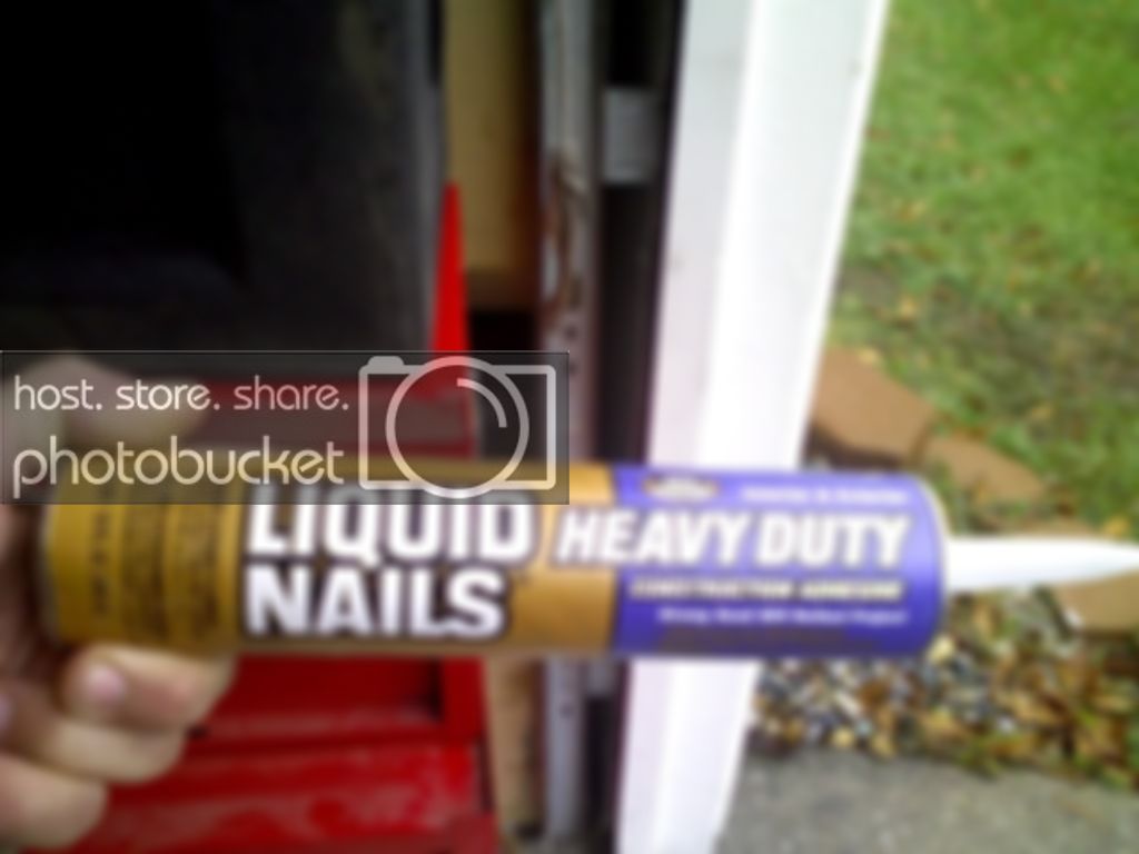

its really all personal preference but ive always used this
ive yet to have a box break and ive ran pretty big setups.
But do u seal with that out of interest, ill be getting my sealant in a bit as Ive used sealant before & prefer it to be honest
Its NOT a sealent it is an adhesive.
Liquid Nails is the bastard child of box building.Can you use it yes, SHOULD you use it NO.There have been a many threads explaing why.But if you want to use whats right, its "wood glue" for the joints and "silicone"to seal.
Its NOT a sealent it is an adhesive.Liquid Nails is the bastard child of box building.Can you use it yes, SHOULD you use it NO.There have been a many threads explaing why.But if you want to use whats right, its "wood glue" for the joints and "silicone"to seal.
Ok, splendid, ill definately follow this practice as a rule of thumb
honestly, for me (after trying to argue that liquid nails is good for the longest time, you can probably search for the thread titled "so chevyaudio was right..." where i built a box, and 1.5 or so years later when my buddy took some screws out, the box LITERALLY fell apart. as in, as soon as the screws were pulled a wall fell, and so on.) i use titebond II or elmers probond as my glue, and GE 100% silicone II sealant as, well, my sealant. dont buy the silicone I as on the back they have an adhesion rating.
for wood adhesion, silicone I is a 6 or 7 out of 10. silicone II is a 10/10, so it will stick better in the box seams.
i bead it on the screw it down. then i seal each corner with it as well. nothing is gonna leak and nothing has EVER broke. even at 153+ db at 30hz with everything moving. never failed me so im sticking with it.
