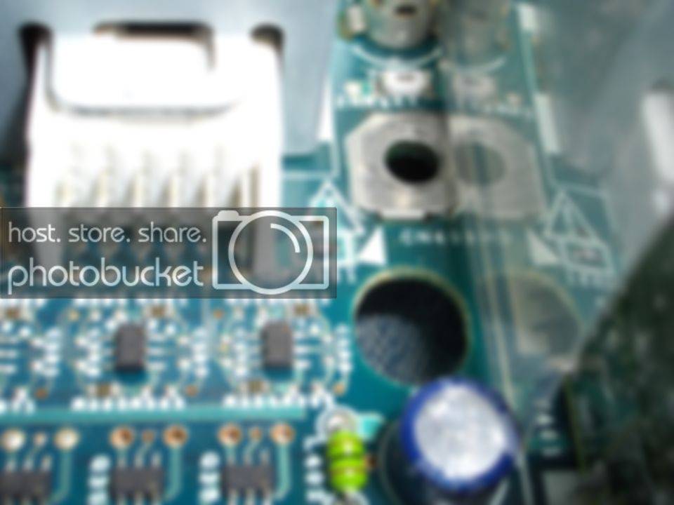

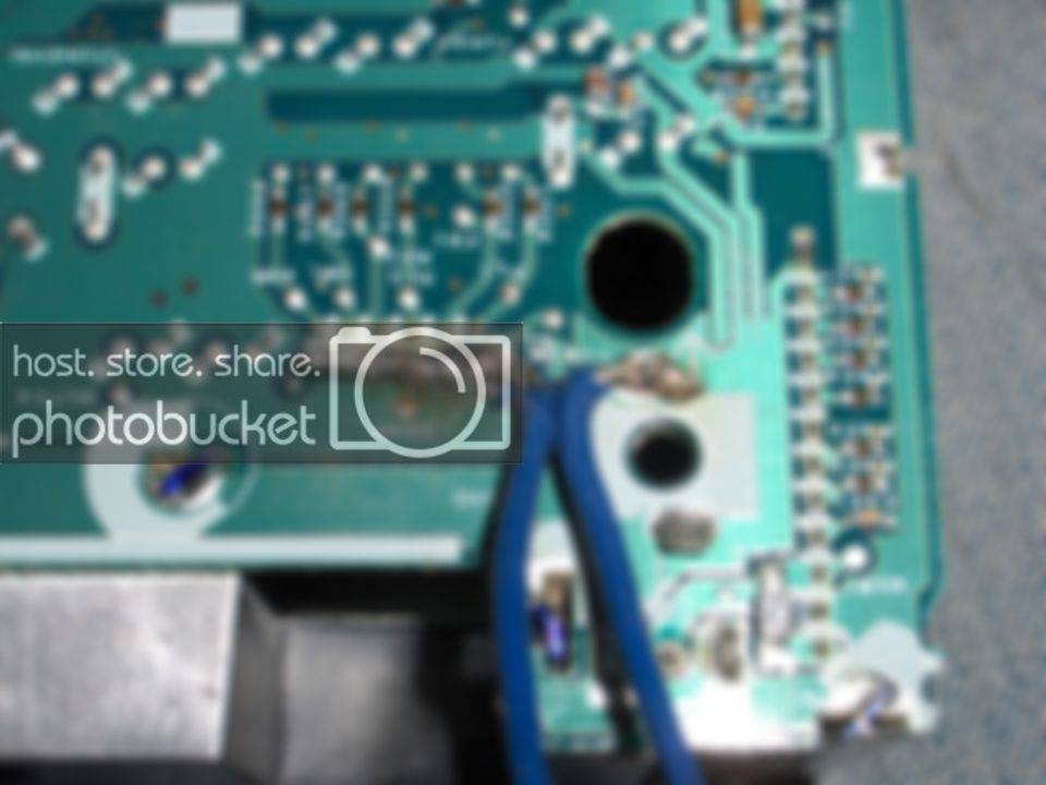

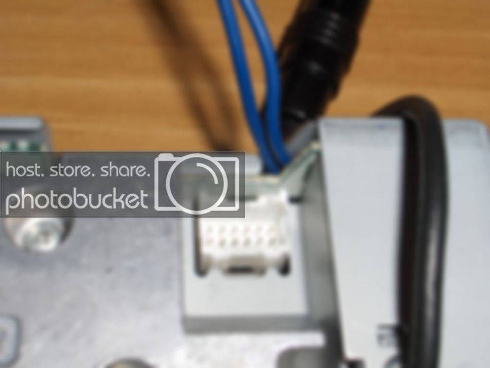

Do you have a "before" picture
No unfortunately I don't. All that was there was the ground pins for the RCA pig tail, soldered a wire across the pins and then another one to a chassis tab.
This is for the PRS880 others may/will be different.
I have one of the top side though. The little chip below the exclamation point with the d on it is the fuse.
i've replaced my pico fuse twice, the second time with a 1A rated fuse. It still blew when I looked at the HU wrong one day. And no, I won't do yours. I don't like to solder stuff that small lol. What I ended up doing was bypassing it. Sick of ripping the dash apart.
