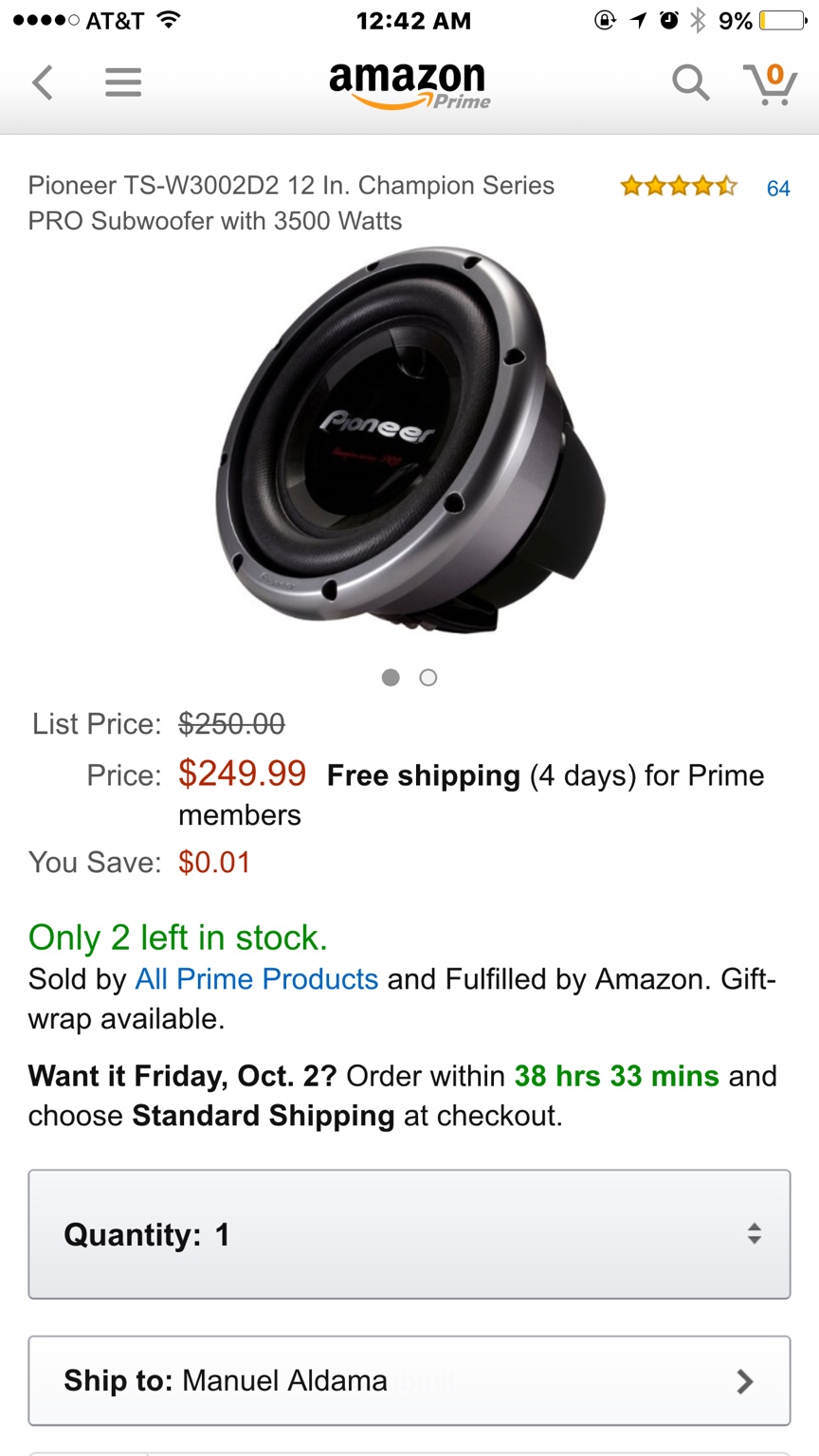

Picking this up for 40$ tomorrow
mrpep
How can I say no. I feel like selling it for 80$ just to make a few quick bucks. What do y'all think of this sub ?

It'll sound like utter sh*t compared to your JL if you use pioneer's box specs. The manufacturer's specs is utterly stupid. You'll need at least 2 to 2.5 cubic feet ported for them tuned to 32-34hz or 1.5 cubic feet sealed.
Take your pick of boxes here
http://www.srtforums.com/forums/f40/official-free-ported-box-plans-56k-no-435910/
Just letting you know, anything above 55hz is non existent with this sub, even if you put it in a sealed box.

Nope not similar, i had the exact same sub. One of the worse subs ever for my music tastes. Horrible for rock/metal, sub does best if you want deep lows.
I wonder if i can use my t-line spec'd for a w7. There both 12"s and both 1000 rms. It should be similar, right ?
you can try but most likely its not gonna work out well at all. T lines are very custom tailored enclosures built based on the subwoofer's precise electromechanical parameters. You can't just toss any woofer in there because the Parameters will always be different which can completely throw off the sound.
Those Two subs are NOTHING similar. RMS rating dont mean jack sh*t. TS parameters is the sub's true specs. Learn what thiele small(electromechanical) parameters are and educate yourself a bit, you might actually learn something about subwoofers.
I do mainly hip hop so you think it'll sound decent ?
It should do fine within that genre, unless its old school hip hop.
