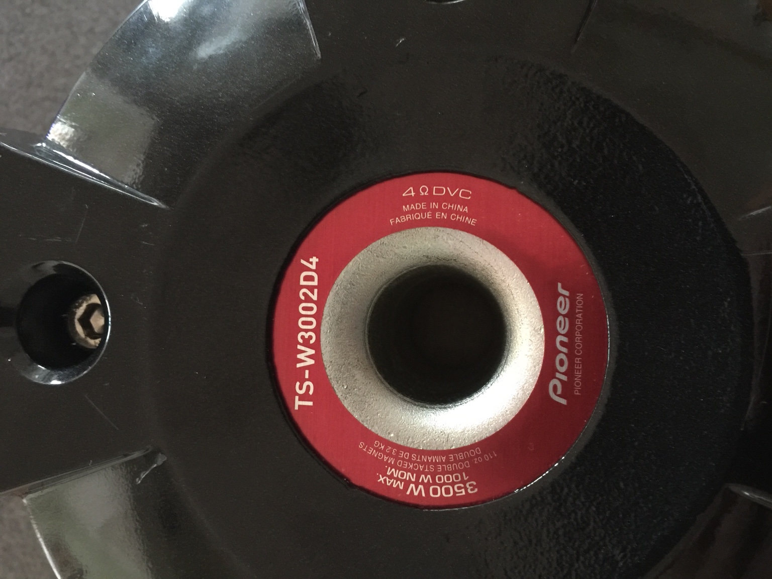

Picking this up for 40$ tomorrow
Nope not similar, i had the exact same sub. One of the worse subs ever for my music tastes. Horrible for rock/metal, sub does best if you want deep lows.
Also used this woofer before I knew better. By far the worst sounding woofer I've used. I'll admit, it was in box built with pioneers specs.

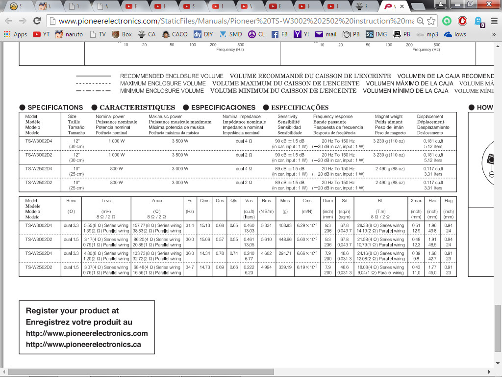

text me the t/s on the pioneer.
64.8 sd
30 fs

They actually sound considerably better and deeper/louder if you go with double the manufacturer's specs, but music choice is limited to dubstep, hip hop, rap and decaf. Nothing clean and strong above 55hz no matter what enclosure i've tried.

Qms? Qts?

It's decent - and I just looked in Craigslist and many are around 140 with box so alone I should be able to get at least 85$ . I also got a KAC-8101D for for 40$ so if I can get 85 I got the amp for free and 5$ for the gas. I was really wanting the amp but when he offered the sub I couldn't say no
