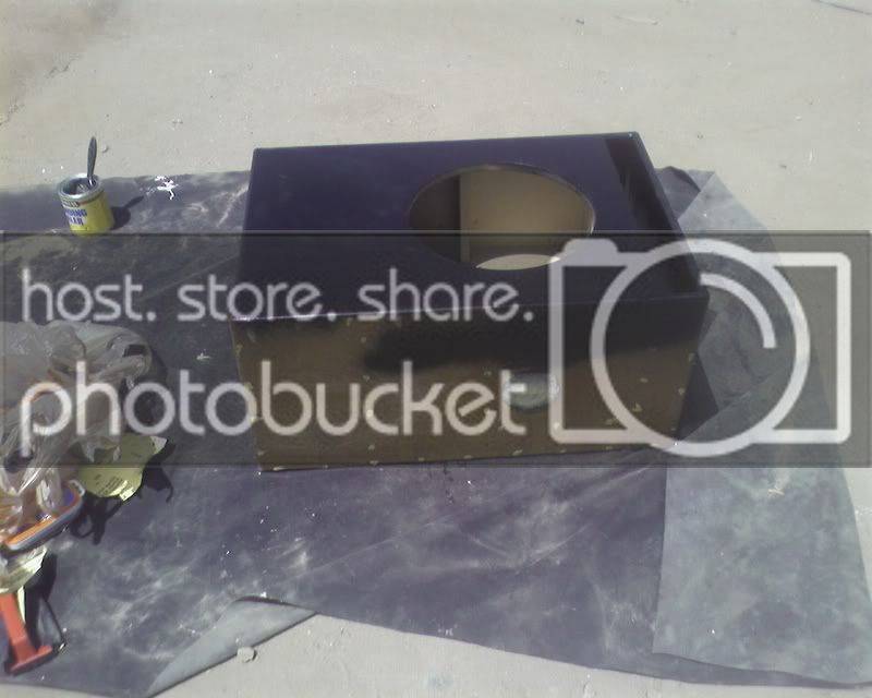

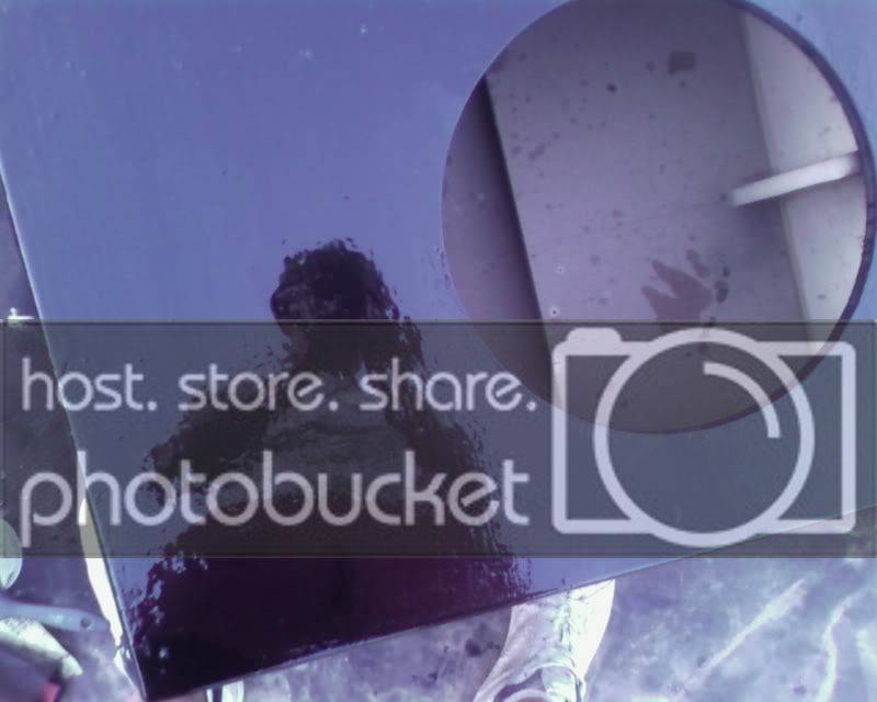

Im painting this box a glossy black. I put on 2/3 of a quart of primer on today. Then the sun started to go down, so tomorrow i got a little bit of primer left 5 black cans of lacqer and a clear coat to put on.
This box has a shit load of screws on it due to all the bracing

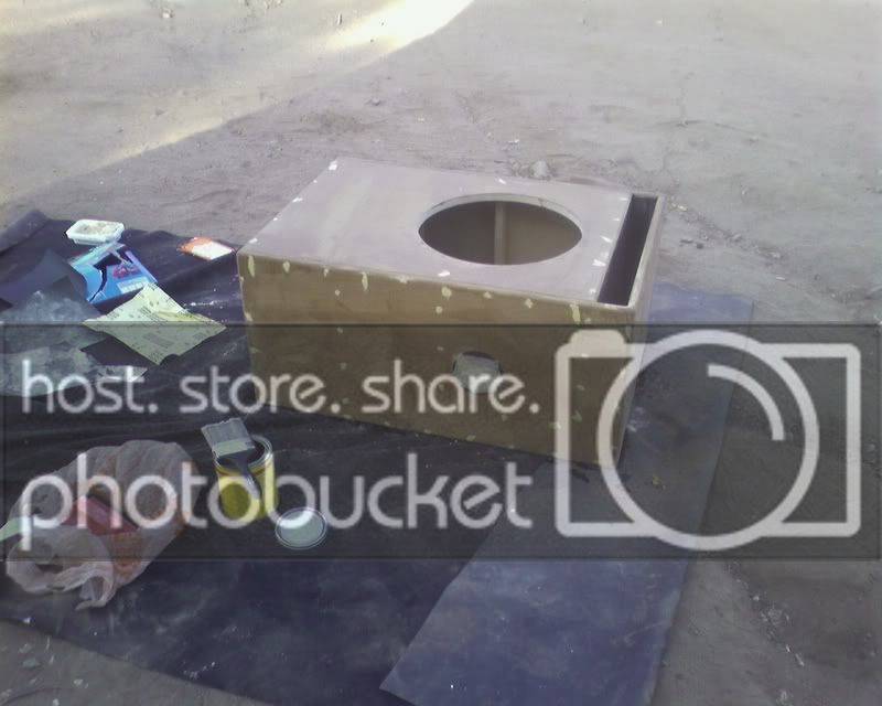

and its the same on the other side.
Ill try and get a shot of the bracing tomorrow.

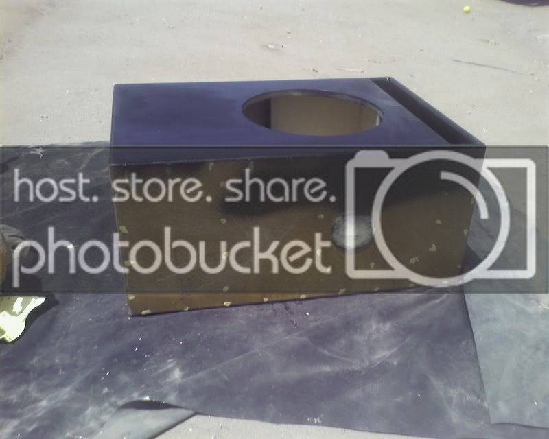

Here it is with 2/3 of the primer on
I can already see my reflection a little bit.
Stay tune for more pics tomorrow.

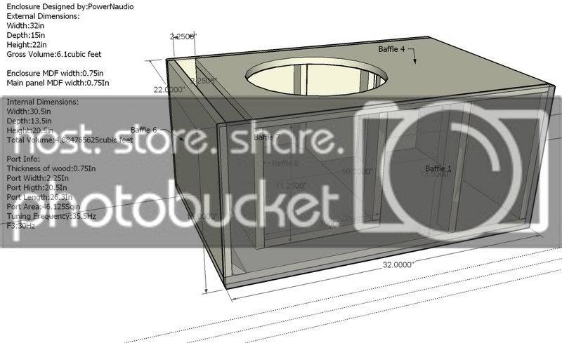

And BTW here is a design picture of the box, those who are interested
I see sanding sealer primer in the 2nd pic form the top. That stuff takes a while for it to cure enough to sand. Well it did when I used it. I also used the entire yellow container of it on a 5 cuft box.

Cool. Let me know at what steps your at. Also in my sig I have some info. The sanding sealer takes a long tiem to cure like 2-3 days before it will sand correctly. If you try sanding it and you see and feel it ball up under the sand paper that means it isnt cured enough yet. After mine cured for 3 days I sanded it and it came off in a white powder.
Hopefully you get the same result that I did...
